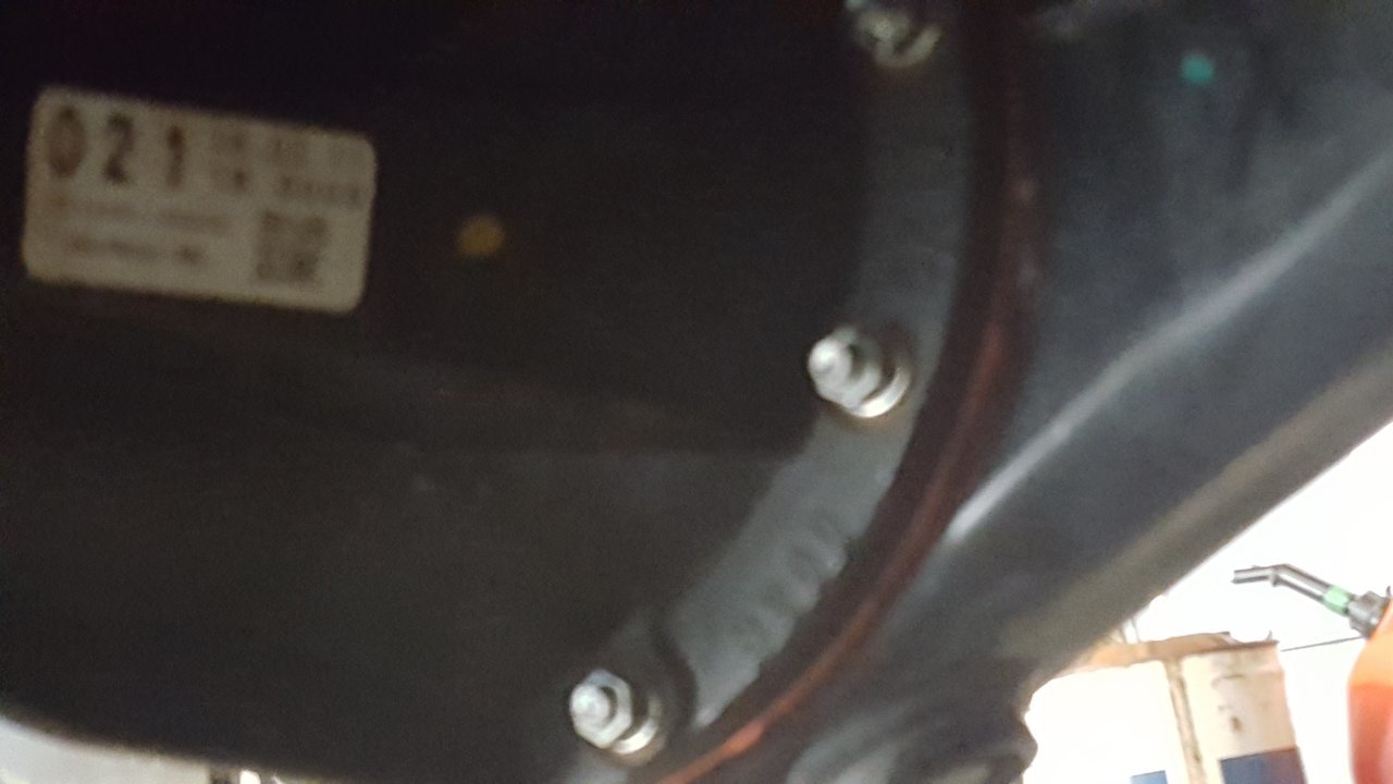

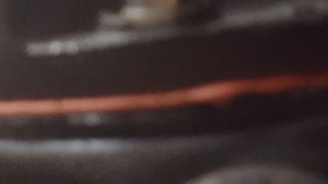

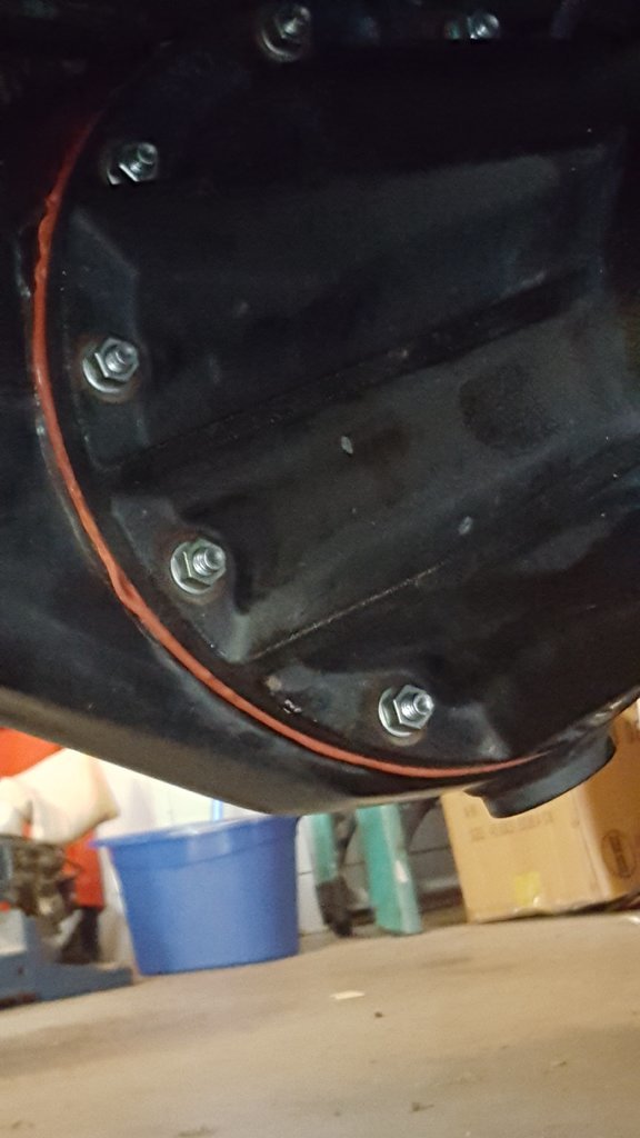

    Read through this and don’t be a jerk. RTV is not part of the TSB repair. A gasket is though.
    We all agree RTV gets the job done. When it’s done by your shade tree mechanic. Not the dealership.
    Also FWIW, Permatex is just the junk “name” brand they sell at the local auto stores. They aren’t anything special.

    I had to remove the rear gear on my race car more times than I cared to count. I used RTV on several occasions, mostly when I didn't have a gasket available. RTV is cheaper and pretty reliable but it makes a mess for the next time you need to replace the gear. The surface prep with RTV is a pain hence the preference for the gasket plus the gasket is quicker to slap on. Personally I would have done the same as OP even though the silicone would get the job done. There is no reason a dealer can't service a vehicle to the same standard that the truck left the lot on. Especially with the resources they have access to and a TSB to go with it. Hopefully they make it right
    jsey21 and DavesTaco68 like this.

    They work fine when done right, but they aren't as forgiving as RTV. Gotta be careful with RTV though.... some people get a little crazy with it.
  14. Aug 22, 2017 at 5:10 AM
    #94
    Woodrow F Call
    Woodrow F Call Kindling crackles and the smoke curls up...
    Feb 23, 2016
    #179160
    3,889
    Colorful Colorado
    16 DCSB SR5 4X4 "ikea furniture haulers" edition.
    RTV actually works a little better than a gasket in this application. Permatex makes good stuff.... junk name brand is not quite what I'd call it. Many manuals call it out by name.
    Just to reiterate.... RTV is probably better in this application anyway.
    Now to be fair, he bought an expensive truck and really shouldn't have to be driving around in a corolla or living without the truck he/she is paying/paid for. If they are going to do the work, they should do the work right...... in this case that means following the MFGs instructions by sticking the proper gasket in there. Doing anything different will cause the OP further issues if a warranty claim comes up.
    RTV is probably better in this application, but it's not what I want in there as long as the vehicle is under warranty.... and the dealer should be doing it the way Toyota says to do it.
    jsey21 and peanut29365[OP] like this.

    My last vehicle was a 1996 Tacoma by the way that never had issues, ran as good when I traded it for this 2016.
    You hit the nail on the head with my concerns. I did not build the truck. I do not half-butt what I do in life. I have already went out of my way to provide myself
    with a truck until this is cleared up. It's probably beneficial to someone else to be able to see what others are experiencing across the nation. Thanks
    to All.

    you will be fine i have had trucks that do not even use a gasket on rearend or trans pan. Only a sealant.

    "Is this what toyota had in mind for a fix" -They specified a gasket so no, strictly speaking
    "Is it proper fix?" - Absolutely! When properly applied, I've seen it seal better in some cases
    "It looks like bob's backyard did the work" - That is the only downside to it, it "looks" shady, but that's purely aesthetics, it works when sometimes there's nothing else available or more practical.
    If I was that dealer and wanted to take care of my customers, I would have ordered a couple rolls of gasket making material and have the techs make the gasket in house. Not because it will work better, but just because it looks better and to avoid this type scenario.
    "What should I do?" - It's really your call. Your warranty will be good, and it's a recall so you have nothing to really be concerned about you should be covered.
    "They RTV is uneven and on top is not even evident. I'm concerned" - If there's no leak, it's sealed. If properly torqued, it should stay that way.

    Just pointing out that these two points you made contradict each other in the eyes of the warranty (a legal contract). Below is the OP's update after speaking with a Toyota Case Manager. The Case Manager's reaction, according to the OP, is proof enough that this work left as-is would be enough evidence to likely deny a future warranty claim on this piece of the vehicle. The dealer's documentation has that the official fix was performed on the truck, not this alternative method.
    Note to all:
    This thread isn't about the OP demanding a truck loaner (which he said he didn't), or demanding to jump the recall wait list to the top (which he said he didn't), or rush/pressure the dealership to perform the fix now (which is actually the dealership's choice to do--if they did), or to complain that he had to rent his own truck to meet his business needs while the truck was in the shop (which he hasn't complained about). This thread is about 3 things:
    1. Safety, which we can all agree that while the tech should have cleaned the exterior application area more, the fix done is an acceptable industry safe application.
    2. Whether or not the work done is acceptable in the eyes of Toyota Corporate for the sake of his warranty still being valid on the affected parts of the truck.
    3. The dealership basically committing fraud on the truck's warranty service documentation to Corporate, saying they performed the recall to spec.
