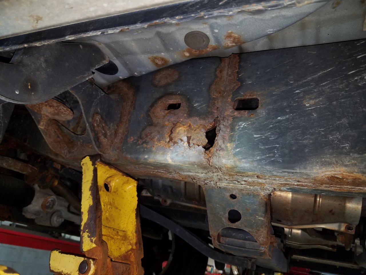

    I may have found a good 2nd gen. Im currently talking to a private seller and I asked for a pic of the frame.
    Can anyone tell me how this frame looks to yall?
    2014. 122k miles. Southern truck for most of its life, I believe.

    Surface rust. Wire brush it. Por15 it. Treat annually with Krown, or Fluid Film, Woolwax, whatever you’re preference.

    Its good. Bad frames look like this. Small spots are normal.

    Looks like a one year old NE frame
