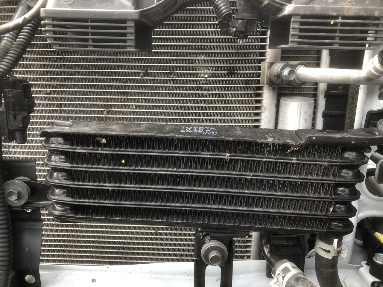

    We can help, but the questions you are asking should be basic ones for your dealer. But since yooure getting a deal, that makes it a bit more justified... if its a really good deal. I elected to pay a bit more at a local dealer who has a very good technical team working for them that were very good with my previous Toyotas, so sometimes getting a good deal comes with a price. Anyways...
    If you look inside the grill from the front, you will see the small auto transmission oil cooling radiator right below your horns in the left side of the main radiator (right side if looking from the front): image.jpg
