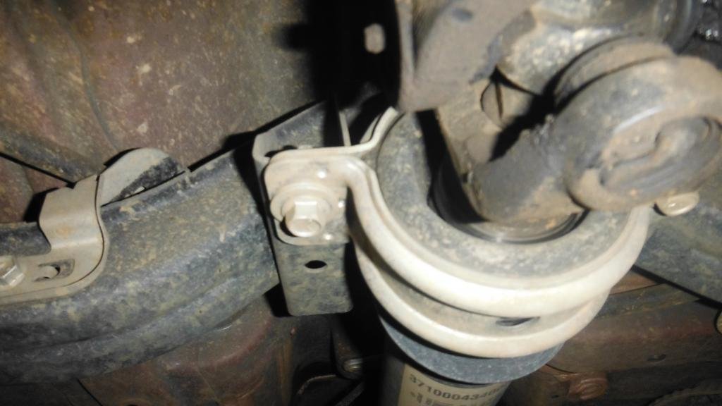

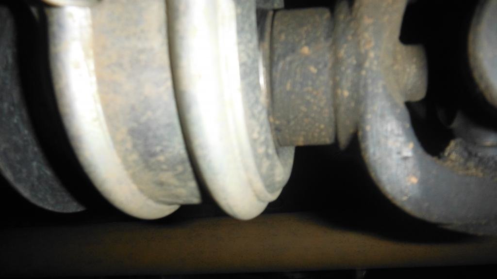

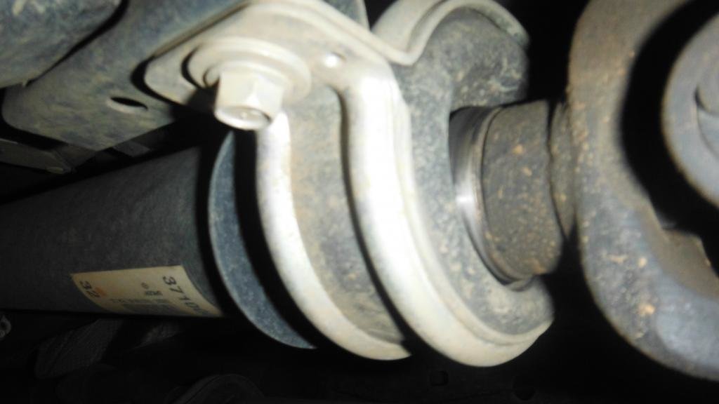

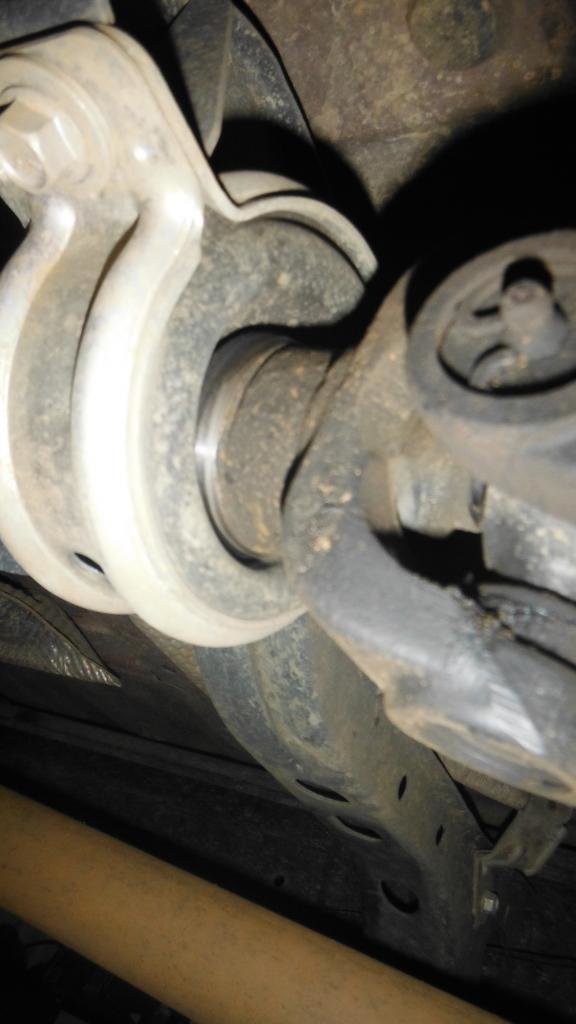

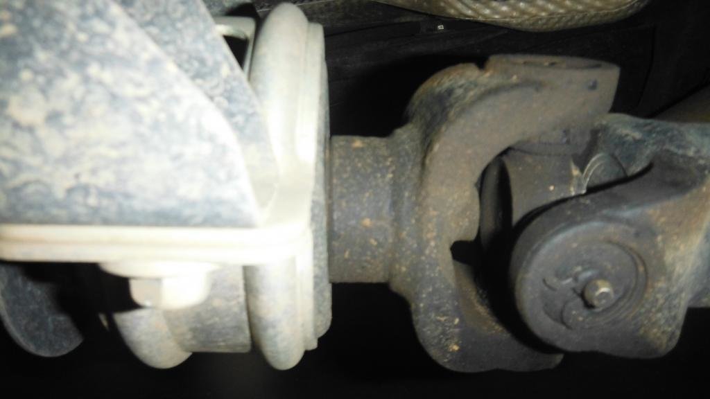

    After installing my Icons I am getting a slight vibration around 30mph, then it goes away. It feels like a small wave of vibrations. Barely noticeable in the cab.
    I crawled under the truck to check the driveline angle and found that I have a slight rub at the CB bracket. After looking at this, do I need to invest in a CB drop?
    Here are some various photos of my driveline

    Based on how the universal lines up almost straight I don't think dropping it would help. Do you think the bearing might be bad?

    Don't think so. I was wondering if the little rubbing that I noticed on the rear side of the CB drop would be accounting for the "vibration"

    It appears you need a new carrier bearing

    Okay, where do you want it delivered? Im gonna strip everything off first:D:D
    You serious about the carrier bearing?
