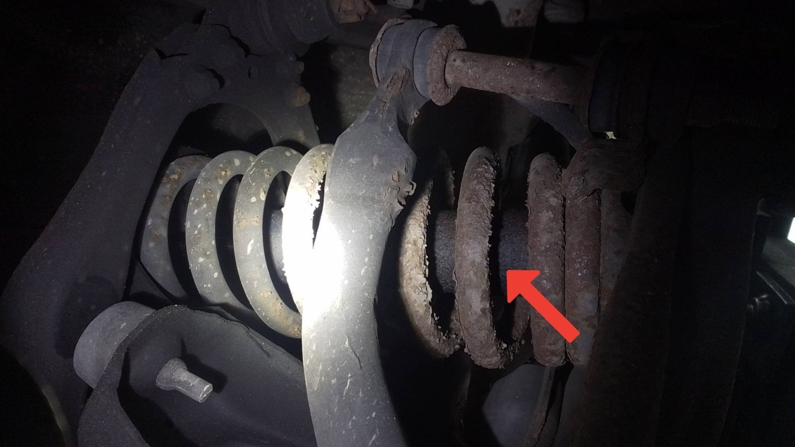

    They included this image below for backing up the struts replacement.. guess they have a point. But they said these parts were leaking. As for the differential fluid change needed , it states "Your differential fluid needs to be changed due to the mileage on your vehicle."

    Its 5 lug....so strut cartages ...$40 ea X 2......$80
