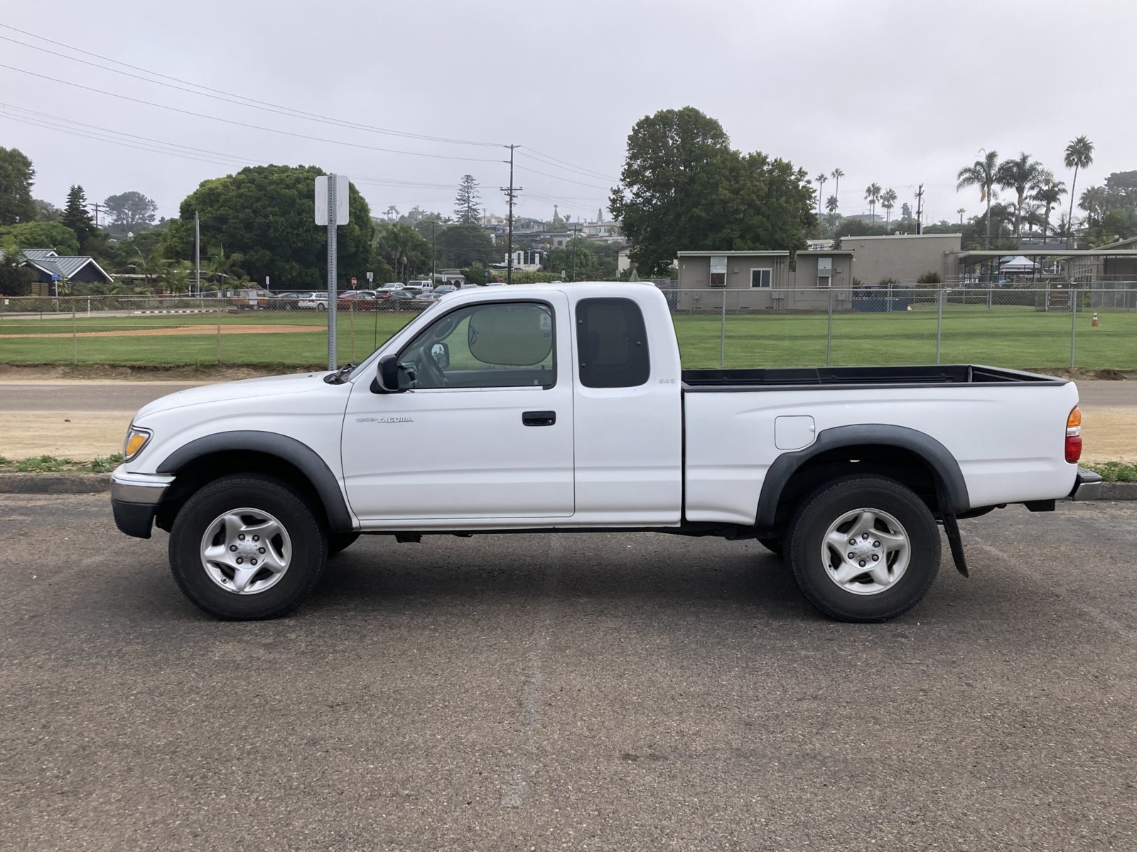

Does this ride height look stock?
Discussion in '1st Gen. Tacomas (1995-2004)' started by Scutter, Oct 18, 2023.
  1. Oct 18, 2023 at 2:15 PM
    Scutter
    Scutter [OP] Active Member
    Jul 4, 2023
    #428289
    38
    Scott
    San Diego
    2002 Tacoma Extracab SR5 V6 Auto 4X4
    All stock
    Does the ride height look normal for a stock v6 4x4? Back end at the fender flare is about 2 inches higher that the front flare. Thanks373A3201-47FF-4677-9B60-F7EA27818F2C.jpg

    I'd say just about.

    Thanks, just getting ready to upgrade the shocks. Wanted to make sure I didn’t need new leaf’s or coils.

    yup. front springs are just sagged. Some rake is normal. You said you have monroe shocks in the back? Do you also have there "quick strut" (pre assembled coilover) in the front? those are known to be about an 1" short.

    It's been many years since mine was stock but that is how it looked. I think mine had about 1.5" of rake, that was with less than 40k miles on the truck.

    Andy, Crap…… the front is the Monroe Quick-Strut. Looks like I ordered the wrong Bilstein pack… thanks for pointing that out. Hopefully I have time to change my order to the Bilstein pre assembled coil over pack.

    If you haven't bought coilovers yet, I recently installed these which are as close to stock as you can get without going OEM.

    Thank you Bill. That is the exact Bilstein pack I ordered. I’m assuming the pre assembled front shocks are easier to install? Will I still need a spring collapser? I would think not.

    Nope, that's kind of the point. They will come like this, one will be marked driver's side, out of all the suspension upgrades I did this was by far the easiest. :p
