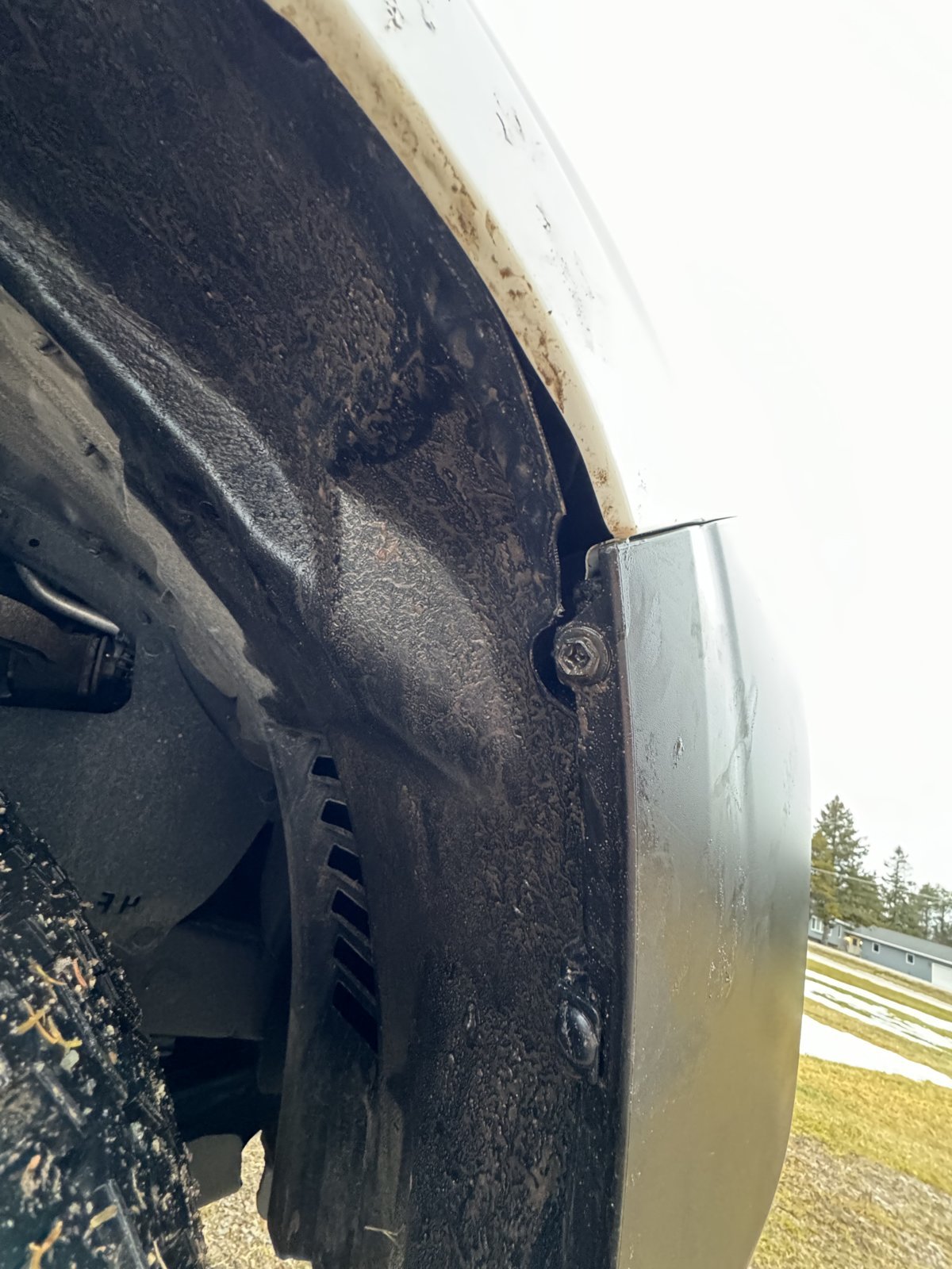

    Noticed my fender liner was all jacked up. I tried removing that Phillips head screw and putting it behind it but it pops right back out. I bent it and got it up there as much as possible. Just send it?

    I think your fender liner is indeed "jacked up". Looks like it has torn away if I'm seeing things correctly.

    Yeah not sure how, musta been like that when I bought it, just never noticed. Do they sell oem replacements by themselves?

    Looks broken off . Piece missing …

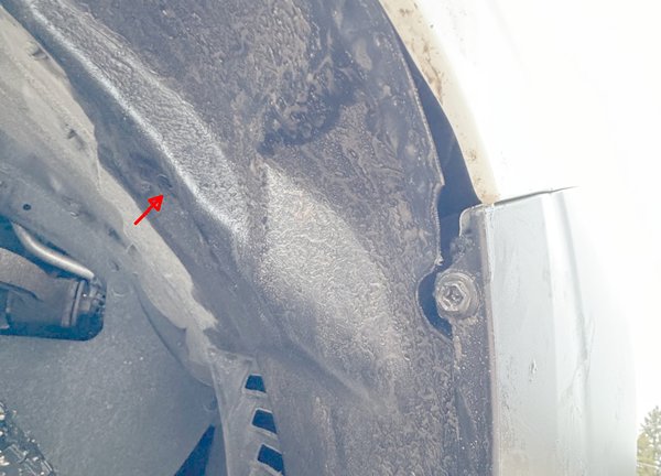

    Check if this push clip is loose. If it is, replacing it will help keep the fender liner in place:
    You will then realize replacing that clip is a pain in the ass. :devil: Replacing the whole fenderliner involves replacing ~15 of those clips.

    Thanks man, I’ll go check. I didn’t see that one! Did see the one on the fender edge it’s in there, looks like this liner is bent. Is it plastic or thin metal? Almost feels like a really thick plastic or thin metal, wonder if I can shape it with a heat gun once the weather warms up

    It's plastic. Compare against the driver's side to see if it's gotten an extra bend or kink in it.
