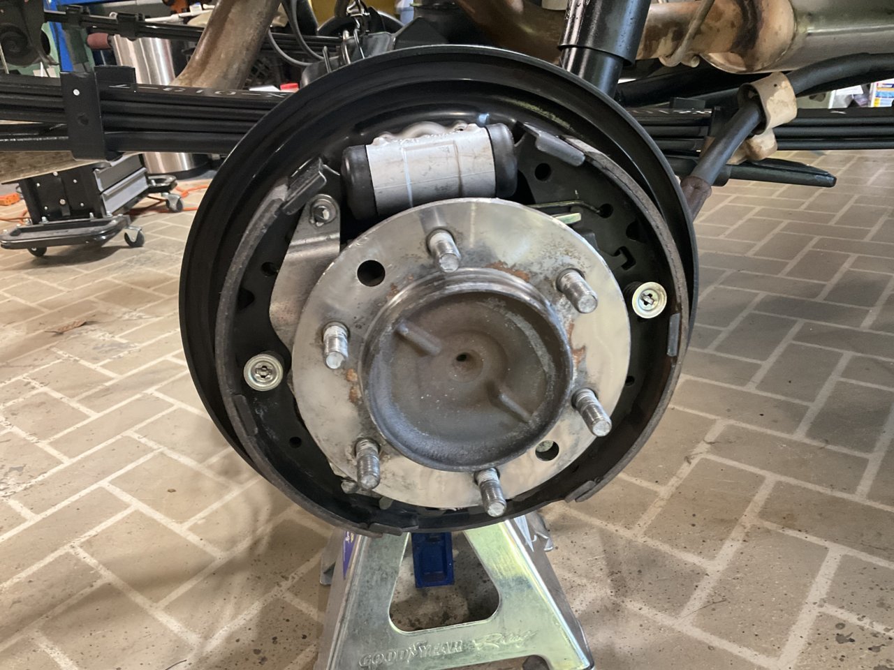

Does this sound like the rear wheel bearings?

    sounds like a hand thumping a tire to me :confused:

    Sounds like something dragging to me.
    Almost like the sound of shoes against the drum.

    that’s what I think it is too.
    I had the drums off then resurfaced them.
    I didn’t adjust the shoes afterwards.

    100% start by adjusting them, if they are stupid loose they will grab then let go and make noise.
