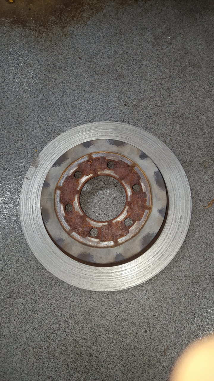

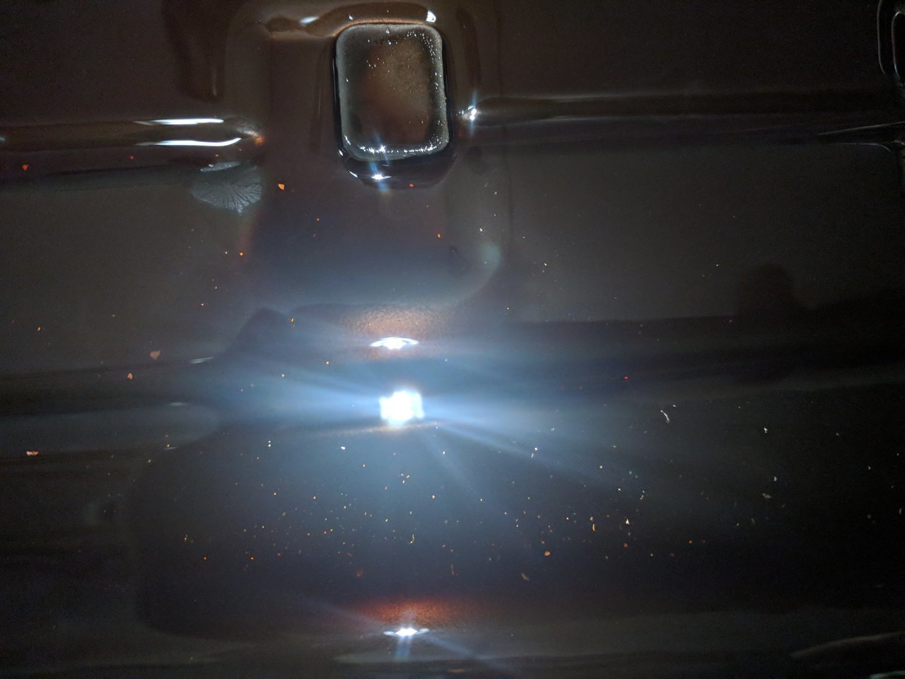

    He'll if you ask the SA they can check with the technician and most of us are happy to do more work and get paid more. But then you have to deal with parts not having the gasket or the filter in stock.
    Most people here dont count as regular customers, most dealer customers are mechanically dumb and should not be allowed to change the spare tire, yesterday I had a guy who's brakes were beyond metal to metal and didn't want to pay for new rotors.
    I had a guy a few months ago, brand new car and he was super pissed that his fog lights weren't working, he had his high beams on so his fogs automatically turn off, I turned off his high beams and magically the fog lamps now work, he's mad since his old other brand truck didnt do that.
    I printed out how the lights work from the workshop manual that we use and gave that to him, he left looking sad.
