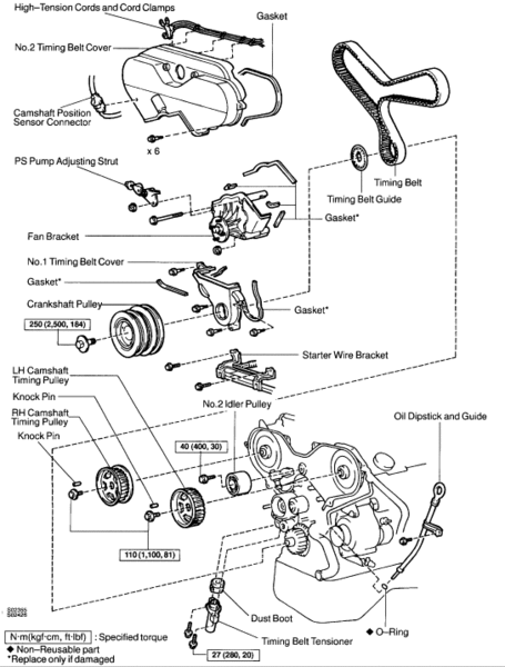

    To get to the water pump on the 5VZ-FE you have to pull the timng belt. Why not replece it since you are already replacing the belt.

    BLU LOGIC bt, avid, weather tech mats & rain guards, 285/70/17, BenWA's totally AWESOME power sliding window mod.
    Timing Belt Replace
    alldata calls for 2.8 hours
