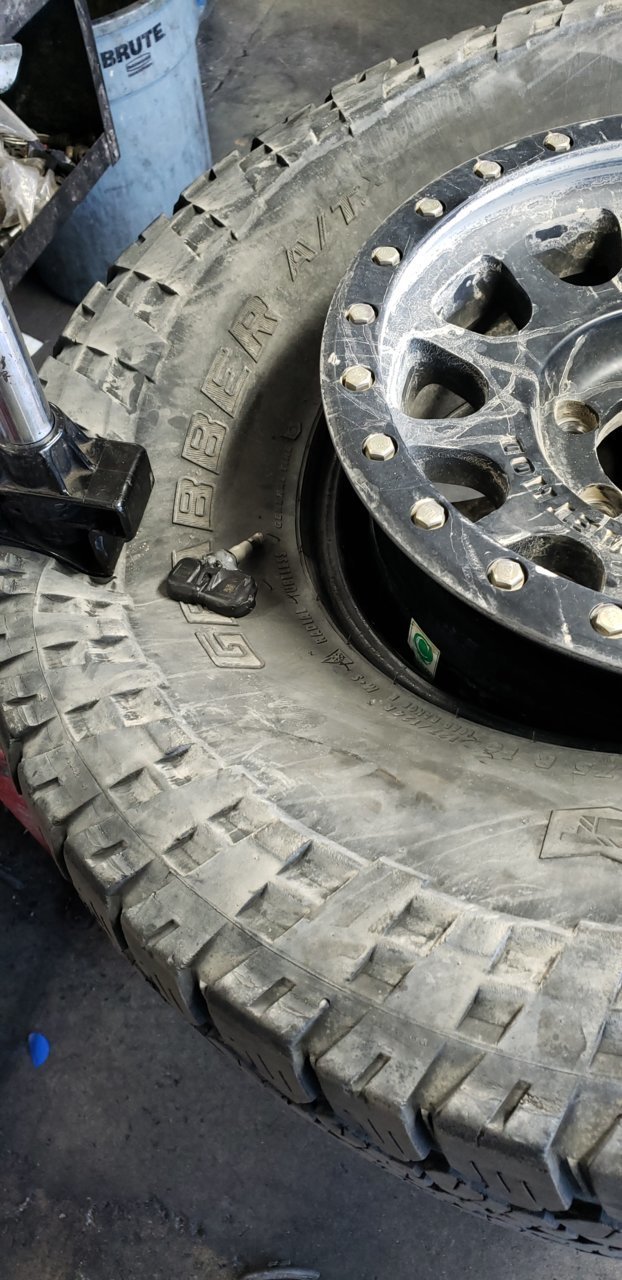

    generally no, the sensor does not need to come off to do a tire repair.
    But...I've learned to remove the sensor before taking the tire off of the rims when the tire is bigger than the OEM size, simply because the tire bead can grab the sensor and damaging it when the tire machine is spinning the rim. This applies to a sensor mounted on the valve stem
    here you can see plastic epoxy that I used to repair my own sensor years ago when I installed my first set of 35's back in late 2008. That sensor lasted up until a few weeks ago when the battery finally died..

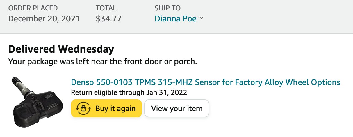

    Monkeyproof, is this the sensor you ordered?

    that is the very same sensor that I ordered
