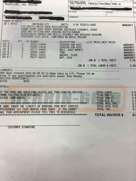

    See attached image of explanation for my squeaking issue, I just got it back from the dealership today. Basically the front body mount bushing was installed by the factory sideways which caused the body to hit it causing a rattle and squeak when accelerating. Once they replaced the bushing I did not hear anything else squeaking or rattling.

    Gotta love that Toyota QA!
