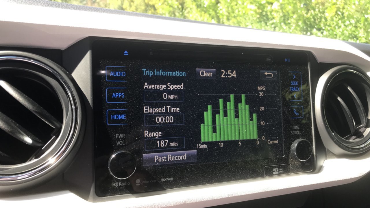

    Nothing works in my truck lol.

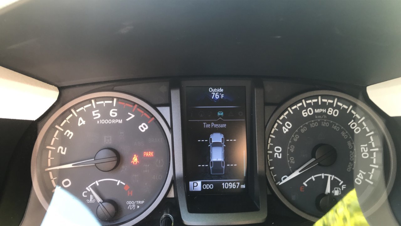

    Blank in accessory mode and with engine on. The tpms has been showing —- since November, the range and mpg has been blank/showing 0s on the info screen, and 0 elapse time since February or March 2020

    2020 DCLB SR5 built 8/20, not working. All zeros. Everything else works fine.

    2019 DCOR mine works, fyi it measures in minutes.
