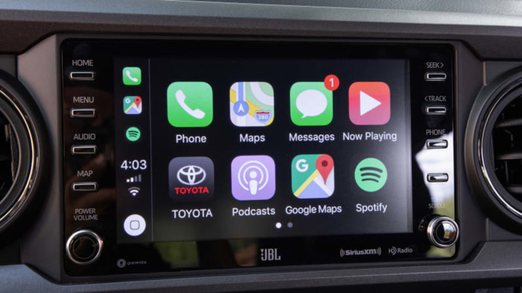

    My 19 has it too but its aftermarket. Unless your truck has Entune 3.0, which is the new stereo with carplay, its aftermarket. It's likely a dealer add on added prior to you buying the truck.

    In 19 did they have the push start or key start options. I know the key starts didn't have the remote start.

    Mine works just like factory too. Factory remote and hit it 3 times and it starts. I also have the cell module so I can use my phone to start it when out of fob range.
    If you have this radio it's not factory remote start. The "buttons" on the side and knobs are the easiest giveaway.
    It would need to look like this one to even have a chance of being factory.
