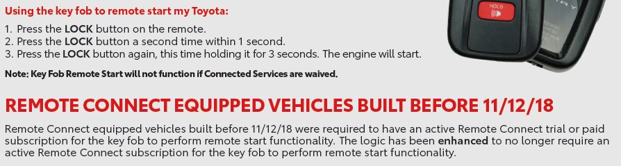

    2" ToyTec/Eibach Pro Sport Lift Kit -SparksParts.com 3/4" ToyTec Front Top Plate Spacer Kit -SparksParts.com SPC Performance Upper Control Arms -SparksParts.com Nitto Ridge Grapplers 285/75/17 (34") -SparksParts.com 1.25" Spidertrax Wheel Spacers -SparksParts.com Hypertech Speedometer Calibrator -hypertech.com Predator Tube Steps -SparksParts.com BAKFlip G2 Tonneau -SparksParts.com OEM Rubber Bed Mat -SparksParts.com OEM All-weather Floor Liners -SparksParts.com Gentex Frameless Mirror with Homelink @RJP869 Subaru/Kicker Tweeters -amazon.com Kicker Door Speakers (x4) -crutchfield.com Radio Knobs @Tacowiede Vehicle OCD Glove Box Organizer -amazon.com ‎JoyTutus Center Console Tray -amazon.com FormulaOne Pinnacle Window Tint -SparksParts.com ACDF Horn Kit @BartMaster1234 Total Tail Light S1 Kit @MESO ECT Button Relocation Kit @Tacowiede Minimalist Key Fobs @MESO Ultimate Map & Dome Lights @MESO Fortin EVO-ALL Remote Start w/Cell Module @jmeitz Coin Bucket with Lid @MESO GermesLab Camera Control System @FreshMexicanTaco Natika Front View Camera -amazon.com VLEDS LP Reverse Light System -vleds.com LIFTd Customs Fuel Cap Cradle @JIMMEISTER OEM Power Tailgate Lock -SparksParts.com OEM 2022 Limited Grille -SparksParts.com OEM 2022 Limited LED Headlamps -SparksParts.com LED Headlight Conversion Harness @daveeasa Headlight Trim Plates @MESO OEM Door Sill Protectors -SparksParts.com Diode Dynamics Elite Fog Lights @memario1214 Fog Light Backlighting PNP Harness @daveeasa TacomaTime Dash Cubby Drawer -etsy.com FPE Fogs + High-Beam Module @memario1214
    From attached Toyota PDF.
    Vmax540, 2Nice and skeletron[OP] like this.

    It's not the tech package, it's hard to track down specifically on the Toyota website, but it is any TRD sport/offroad, Limited, or Pro from 2020 on that has an AT. It needs entune 3.0 with the remote connect option, but you only need to pay for the service if you want to use your phone or smartwatch.
    I've noticed that it can be difficult to get the cadence right when pushing the the lock buttons, as you need to wait until it beeps before pressing again. And it also doesn't work if I just get out of the truck(I don't know if there is a time delay or if you need to get far enough away before it will work). I've only used it a handful of times in Oregon, as our weather is mostly mild.
