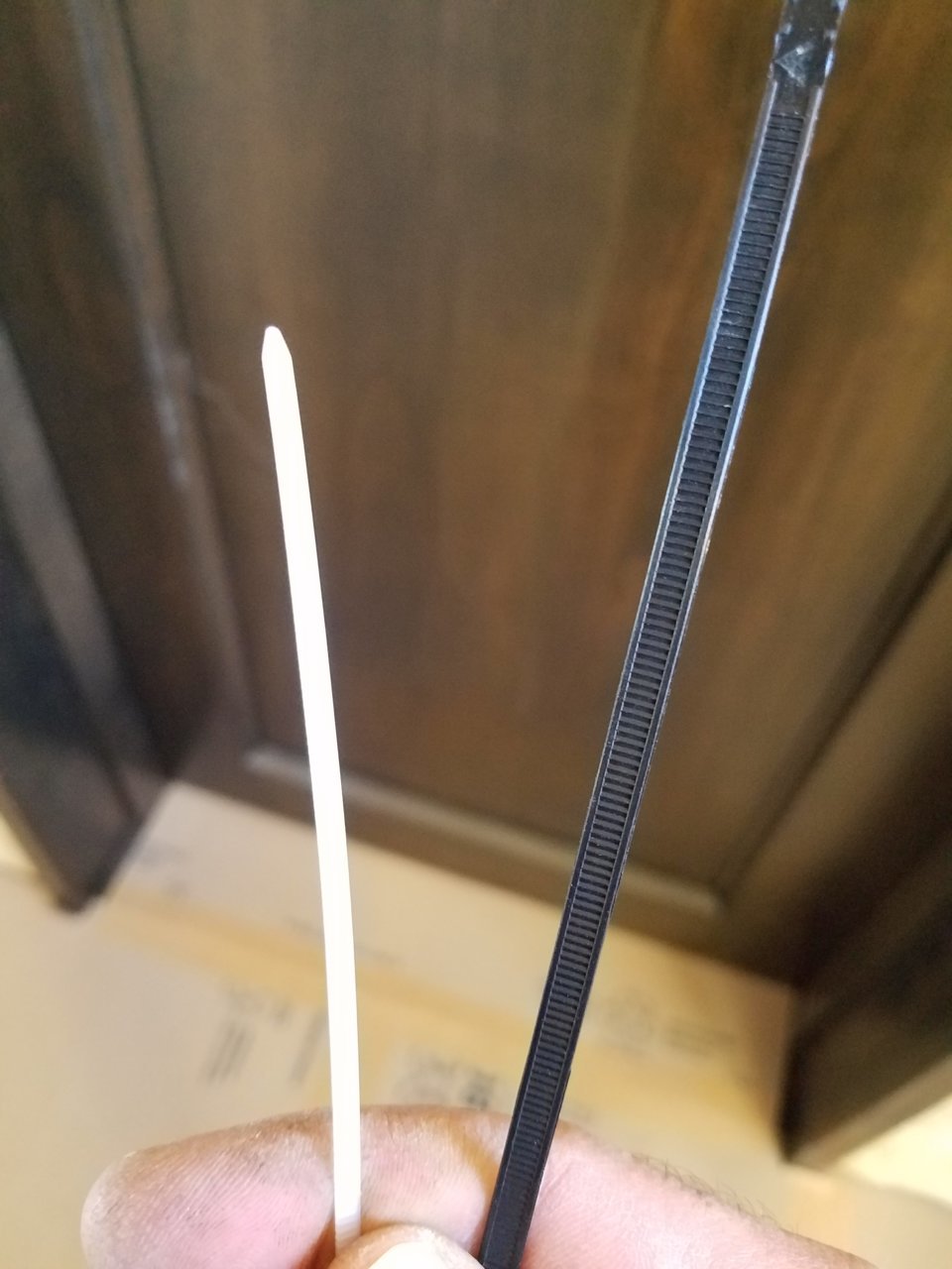

    Ha, you are a better man than me!

    Simple OME/884/AAL lift. 32” WP’s
    Same here. It made it worse. Although my green plastic shim piece was still in tact. Maybe this only works if the shim has worn. Think a shot of very heavy grease is a better solution.

    265/75/16 AT2 BILSTEIN,SNUGTOP MBRP,SPC UCA
    Just did this last night. Thanks for all the good info, but it did not fix the clunk for me :( have an appointment at Toyota in a few days to see if it’s a bigger issue

    2006 Toyota Tacoma
    Thank you. This fix appears to have worked on my 2006 Toyota Tacoma.

    2010 Black DCLB TRD
    The cheapest way to fix this is to add zip ties. I used this method for a while, but it wears out over a small period of time. I ended up replacing my intermediate steering shaft ($205 through a Toyota OEM on Ebay) and my lower intermediate steering shaft as well. After replacing these, the slop was mostly fixed. I still had some slop and a clunk in the steering wheel. My steering wheel still got the clunk in it when hitting rough bumps. My main two issues were:
    1. a lower passenger ball joint that didn't have any play in it until 30k miles after I had the clank.
    2. the lower intermediate steering shaft and the intermediate steering shaft being too far apart in the slip joint.
    After replacing the lower control arm my front end clank went away. My steering wheel clunk remained. I loosened up the slip joint on my steering shafts and forced them much closer together so there was almost no up/down movement in my steering shafts and that fixed my steering wheel clunk. It is silent now going over very rough bumps and can honestly say my steering on my 2.25" lifted Tacoma on 32's is tighter than my buddies stock rig with less than 100k miles.
    I went through 2 lower intermediate steering shafts because I bought remanufactured parts that were about $50/ea. They wore out pretty quickly and I had sloppy steering again within 5-10k miles. I bought an OEM for ~$180 and it made a huge difference. The OEM part was a major improvement. Making sure the shafts were as close together as possible in the slip joint was very important that I did not take into account. After fixing the slip joint shaft spacing, I can now go over washboard or very rough road transitions and it has no clunks or clanks at all.
    I was fighting sloppy steering for easily 60k miles. I replaced literally every bushing in the front end that I could do without major reconstruction. Sway bar bushings, UCAs, sway bar end links, sway bar relocation kit, suspension top hats, shocks, coils, tightening body mount bushings, radiaator bushings, inner and outer tie rods, and finally LCAs. I replaced my rack and pinion bushings with polyurethane bushings which didn't solve the problem. I eventually replaced the entire rack and pinion all-together and still did not fix my steering slop, even after adjusting the backlash 3 or 4 times. in the end it was just my lower intermediate and intermediate steering shafts that returned me to stock steering tightness.

    Tacoma Trd sport crew cab 2011
    Some info that might help other folks: The zip tie mod was not helping anymore and I was getting a clunk even with a new doorman shaft (not OEM), crawled under the car to look at the bushings on the rack while a friend was turning the wheels, seemed like way too much play like around 1 cm side to side. Went about the hassle of changing the bushings to poly bushings and it seemed to remove the noise completely. Thinking that the excess play was wearing out and introducing way more stress on the intermediate shaft than normal.

    2007 Tacoma 4x4 PreRunner
    Seems to have worked! There’s a little bit of clunk left so I might try a larger zip tie
