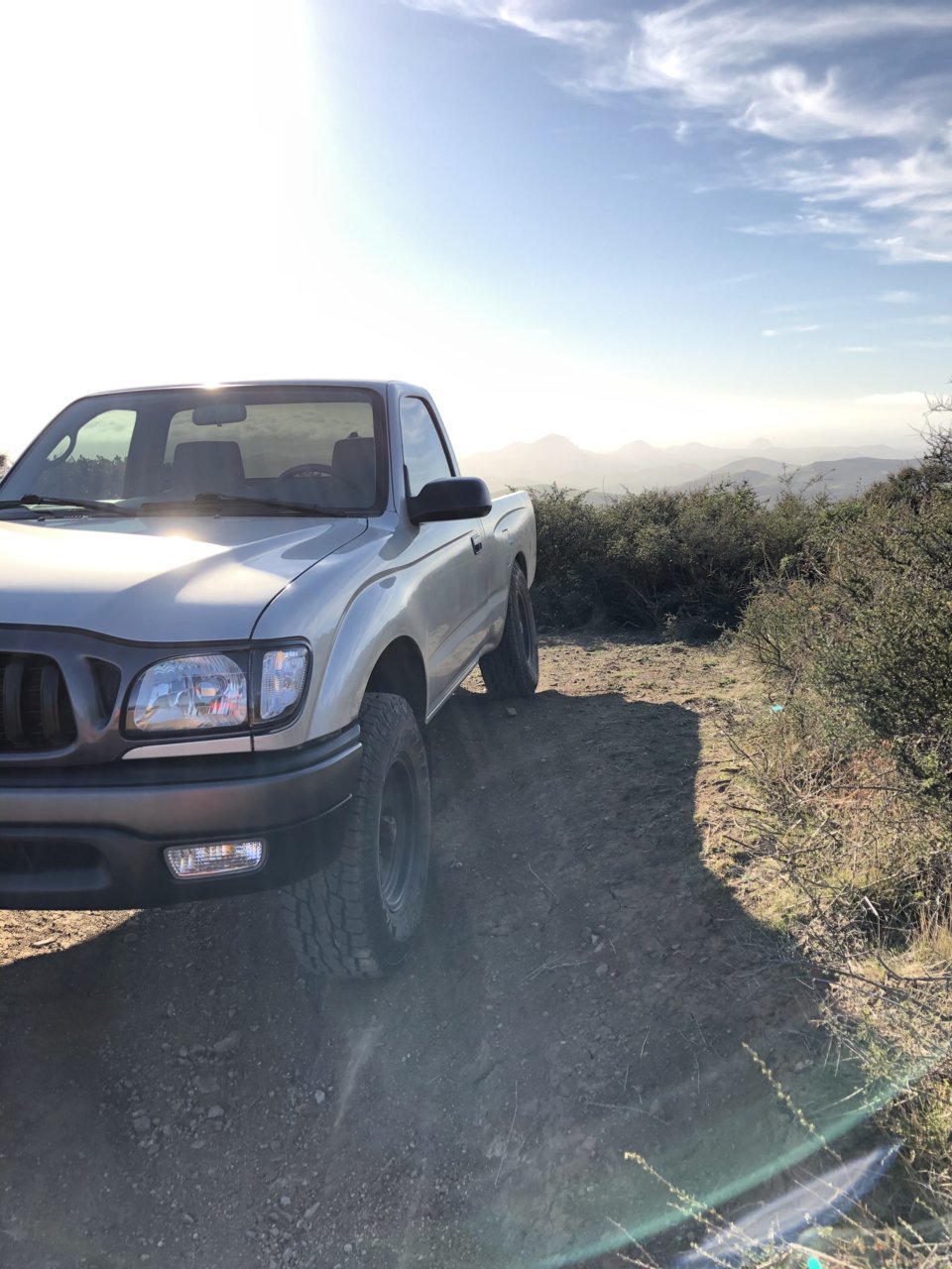

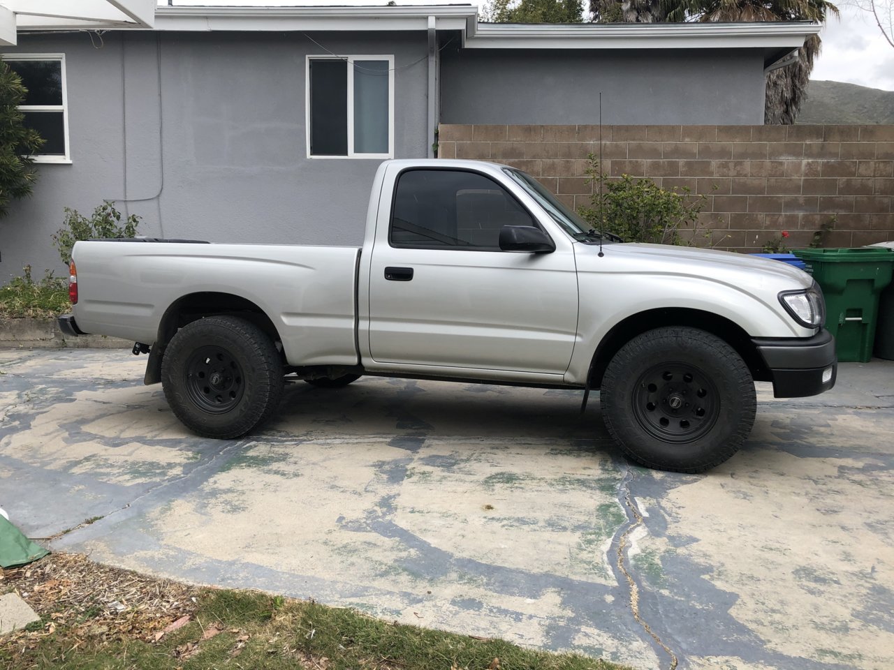

    Got an update for you guys. Finally got the following parts installed on my 2001 regular cab mini:
    Doetsch upper control arms
    Doetsch lift coils - 3” over
    Doetsch DT3000’s all around
    Doetsch adjustable shackles - 1” over
    Upper and lower ball joints
    Inner and outer tie rods
    Sway bar end links
    American Racing Baja wheels - 15x7 +6 offset
    Toyo Open Country A/T II - 30x9.5-R15
    I installed everything per the FSM and the truck aligned just fine. Still some play in the steering - I think it’s the rack and/or the rack bushings. That will be the next project down the road.
    The front end rides great. It’s a little stiff, but predictable and easy to control. The rear end is VERY stiff. There just isn’t any weight back there to activate the suspension. It actually feels like the axle is welded straight to the frame - that stiff.
    Any recommendations on how to relax the rear end a bit? My initial thoughts were the DT3000’s were just too much for the light rear end and overall curb weight of this truck. If that’s the case, would Bilstein 4600’s be any softer?

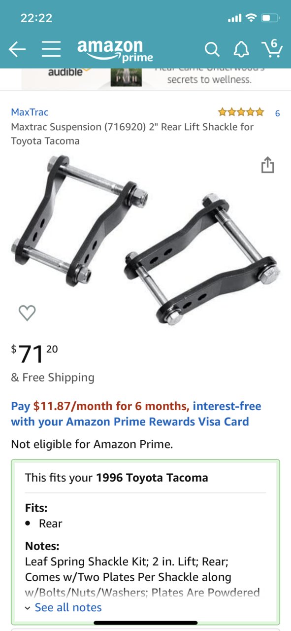

    Great thank you I’m going to try and order this next week, they told me the shackle is backordered for another month and I was thinking about going with the fabtech 2” shackle. Does anyone know if the maxtrack 3” shackle work on our 5 lug or is that 6 lug only.

    My bad I meant 2” maxtrac

    These look identical to the Doetsch shackles. Same price too. I’ll let someone else comment on the application though.
