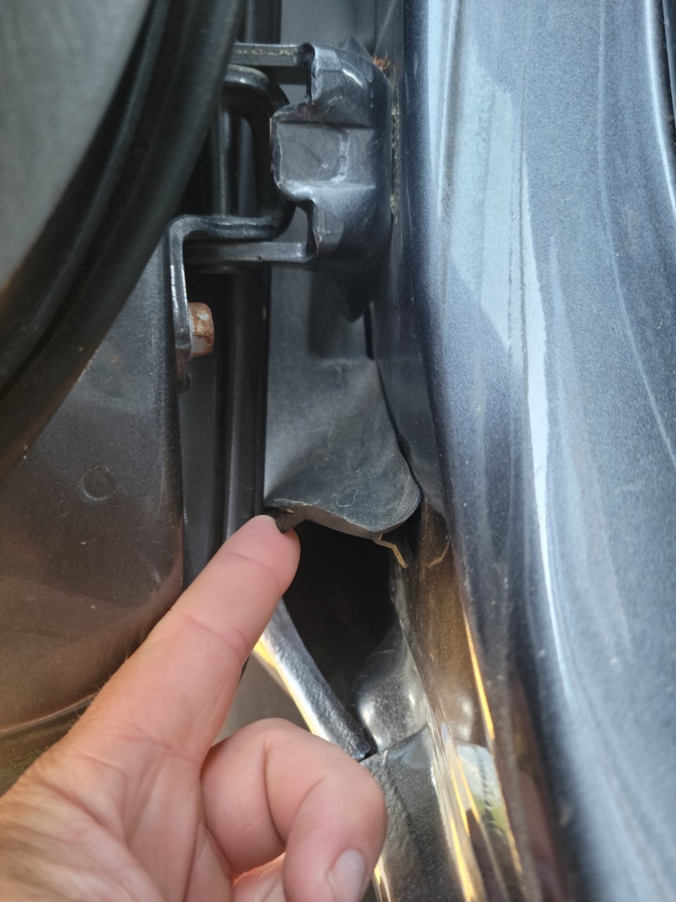

    I get a shit ton of build up in mine. It was also really bad in the cabin air filter until I did the cowl mod. It's spring time in the SE USA so lots of pollen and other things falling. Take care of those dog leg areas!
    That little rubber piece is such a pain to put back in place correctly so I just leave it partially out. Whenever I vacuum the truck it's easy to get to

    So you remove or tilt away the plastic trim cover to gain access?

    I just kind of pull it out from the bottom and shove a vacuum wand in there

    Glad I found this thread, gonna look at doing this after pulling out a metric ton of live oak leaves and mud tonight!
    Discovered the little flap while cleaning my door jams after work and got out as much as I could with my fingers before grabbing a long o-ring pick and pulling out quite a bit more

    If they're that bad you could try a hose or power washer and a wet dry shop vac with a attachment that fits into the Dog Legs. Glad U R cleaning them out - they'd get rusty like everything else on a Tacoma.
