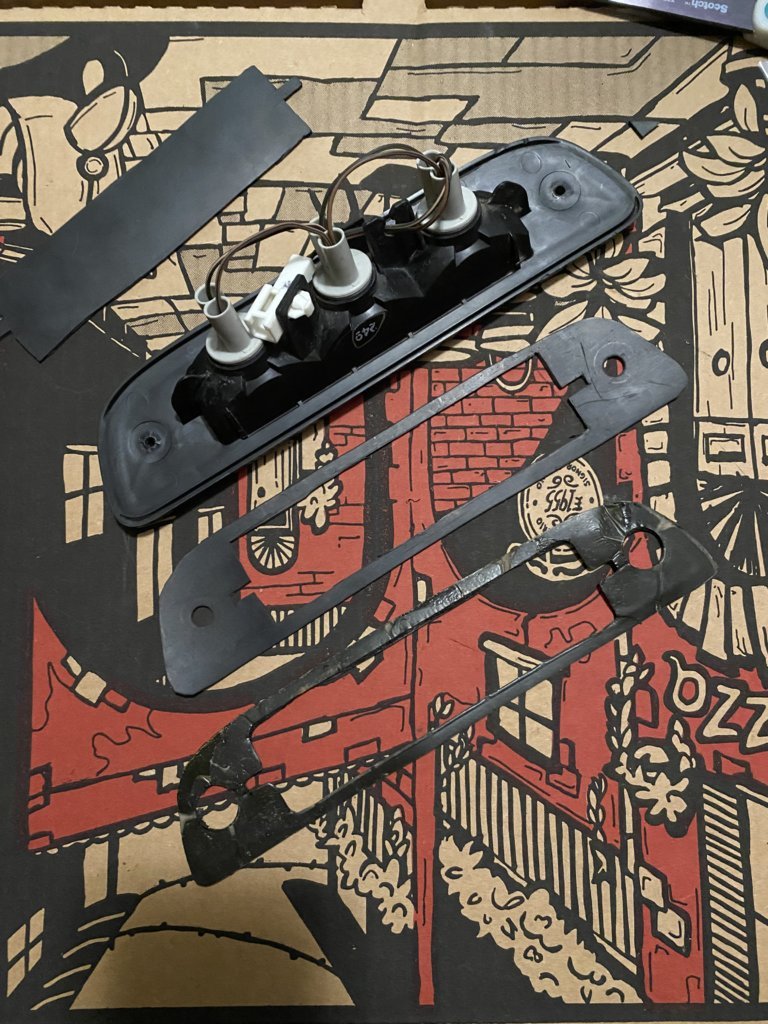

    Took the hose to both sides tonight after work and it was still pretty plugged up, despite me getting out 1-2 quarts per side already. No signs of rust that I could see, norcal but not driven where they salt the roads very often.
    Been trying to eliminate leak points since my floorboards have been swamped after getting the windshield replaced.
    Also found some thin rubber sheet (about twice as thick as oem) at ace hardware to make a new 3rd brake light gasket since it’s supposedly not available from the dealer. Saw in another thread where some guys were running a bead of silicone around it so I added a thin bead around it too

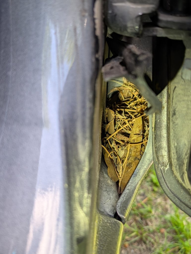

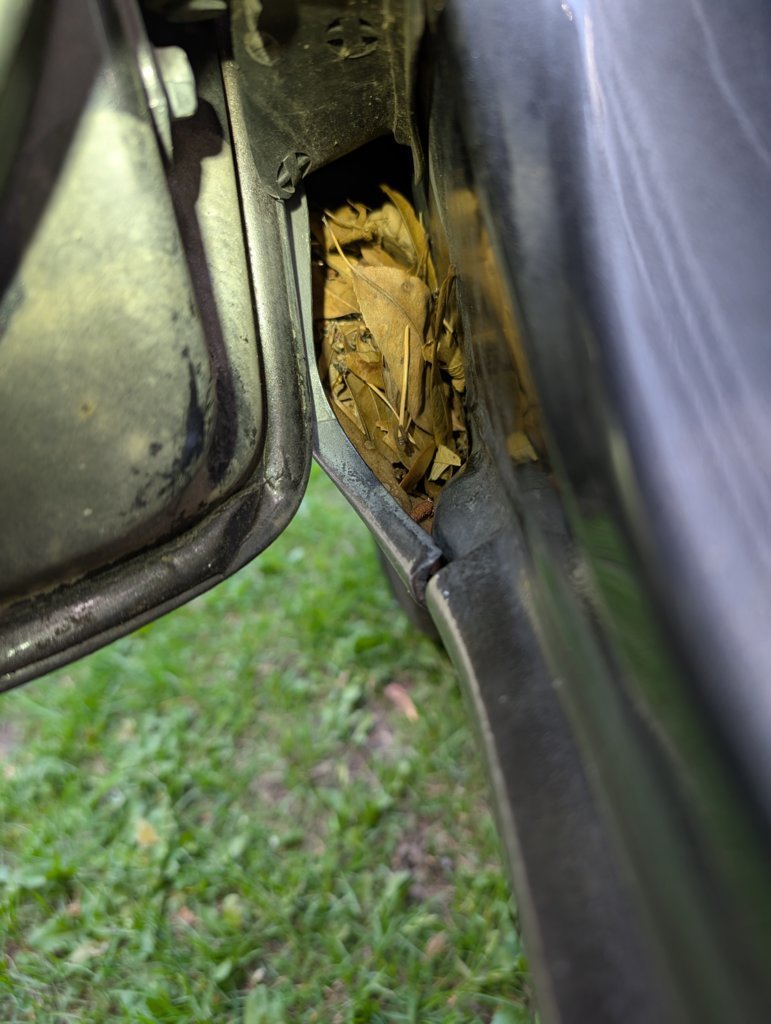

    2014 Tacoma Base
    Driver's side was pretty bad, packed full of leaves. Luckily no rust yet.
    Are there any other collection points/ drains that need to be cleaned on these trucks?

    NO rust in Doglegs but looks like rusted thru on the corner of the door in the picture. Late now but I think some guys run a tube down from the window to coat the inside of the door - rocker panels have plugs you can take out and run spray into. Lots of salt in Michigan like New Jersey I guess. Thanks for posting - good quality pictures.
