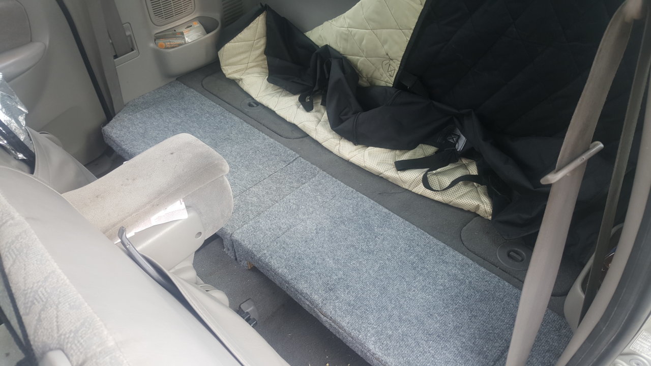

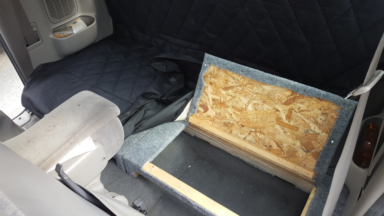

    my dog mod, 20 3/4" x 50" 1/2" hdpb and three 1 1/4" legs cut to around 7 inchs

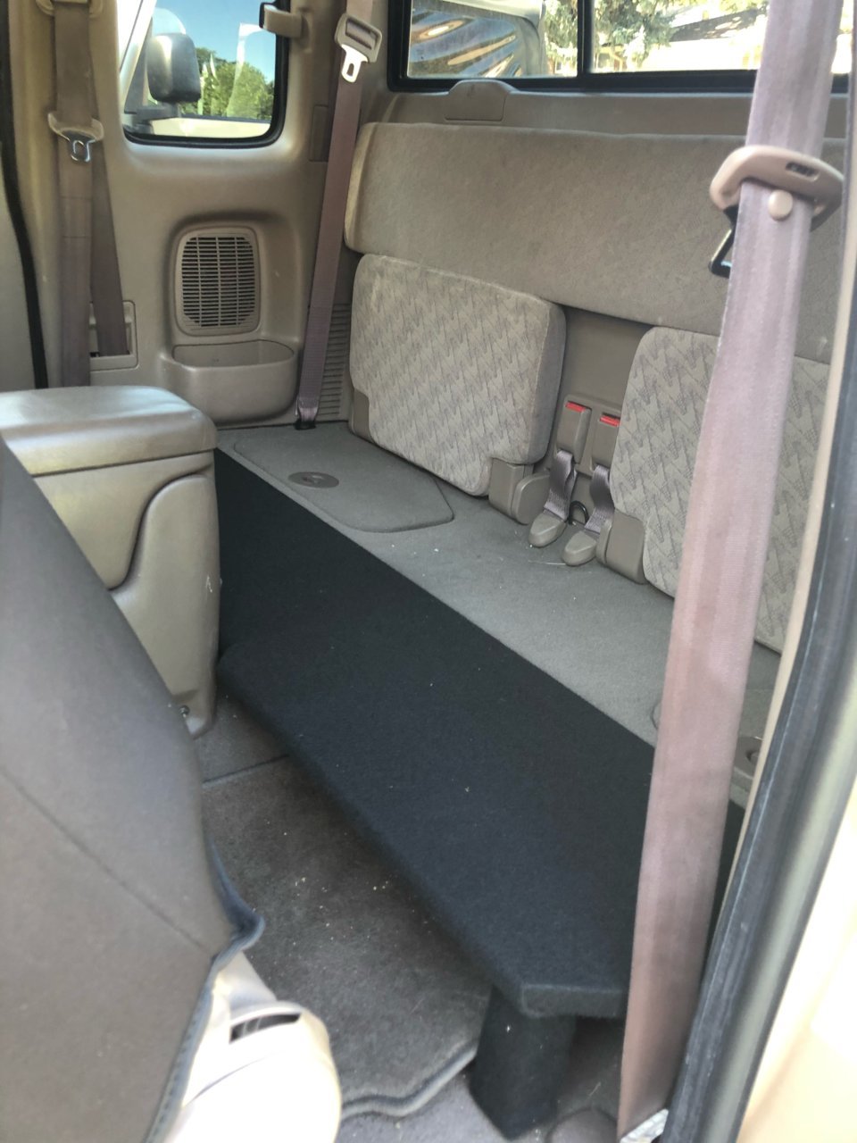

    Hey!
    I finally finished my dog mod!
    I'll link to the build post after I make it in my trucks thread.

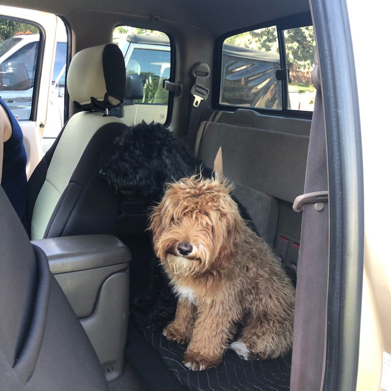

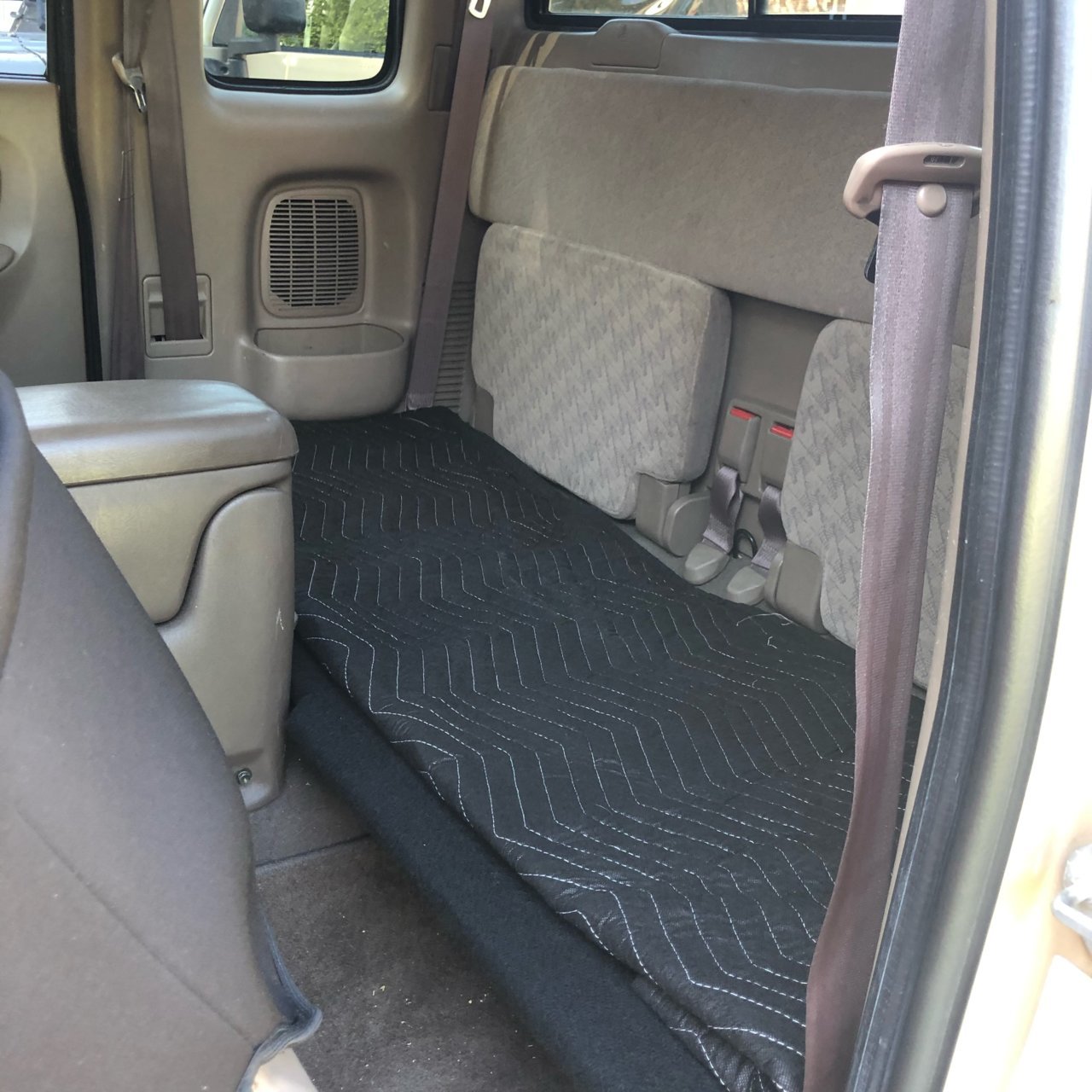

  8. Sep 4, 2019 at 5:08 PM
    #68
    Mile High
    Mile High Member
    Oct 12, 2016
    #199611
    5
    Denver
    2019 DCSB SSM
    Stock

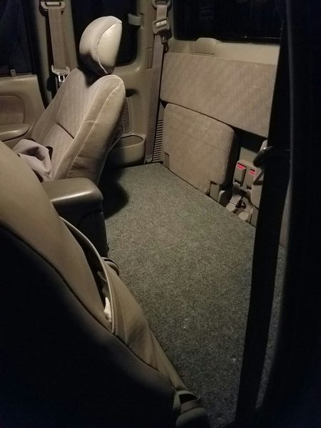

    11” wide particle board from Home Depot, black ‘carpet’ roll from O’Reillys, a few 1x1s and spray adhesive. Threw a new moving blanket down and the dogs loved it. Done in about 3 hours. Thanks for posting measurements. I went 51” wide.
