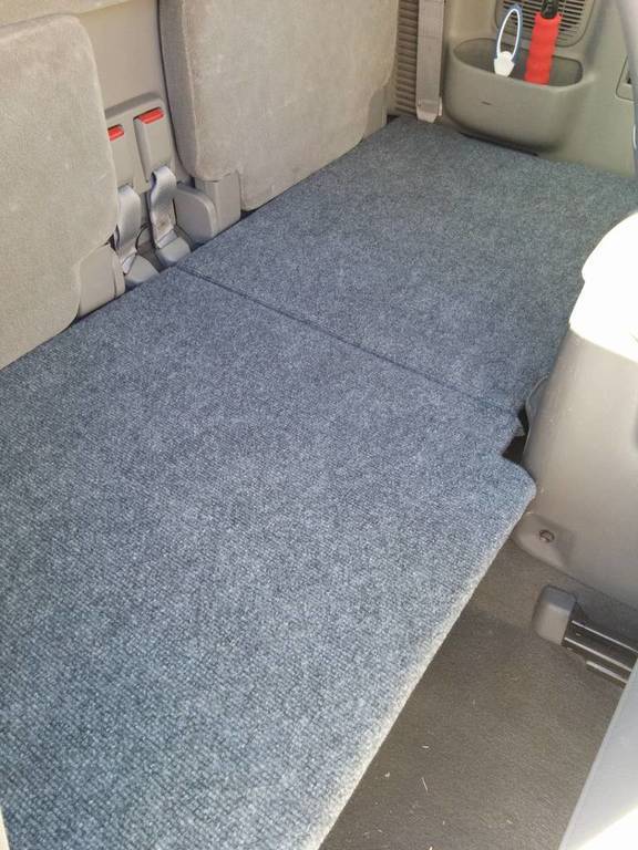

    So, I made platform to make the back one level. It's two separate parts that can be taken out individually and tossed in the bed. When installed, which will be pretty much always, the back becomes a single level that the dog can lay down on if she wants.

    awesome, my black lab mix agrees with your golden on the seating situation in the xtra cabs. got any more pics from underneath of how you built your platform?

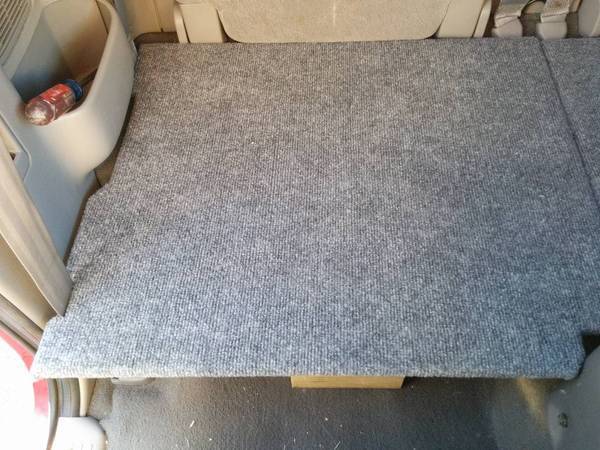

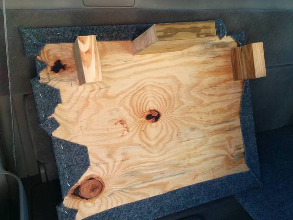

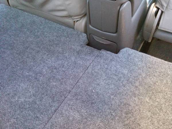

    All shots are of the passenger's side. The driver's side is a mirror of the passenger's, or at least as close as my crude skills allow.
    This is just the half-platform flipped up. So, the top of the picture would sit right behind the front seat. The bottom of the picture sits against the back of the cab under the jump seats. The back half of the platform simply rests on the "shelf" of the cab. The part with the trap doors into the storage areas. Top center of the picture is a 7" tall foot that rests on the floor behind the front seat. Going clockwise there is a corner cut out to fit around the center console, then a 3.5" foot that sits on the transmission hump. Starting back at that center 7" step and going counter clockwise is a 6" foot that rests on a raised part of the floor behind the seat, then a notch for the front seat seatbelt, then a sort of a curved recess to go around the cup holders.
    This shot is from the front shooting into the back. The platform is pivoted back down into riding position. You can just see the 7" center foot. On the left you can see the cutouts for the seatbelt and the cupholders.
    Finally, this shot is the dog's eye view looking forward at the center console.
    All in, I spent about 2 hours. I used lumber that I had on hand already which was a part of a 1/2" sheet of plywood, and a section of 2x10. I bought the carpet at Lowes. It's RV carpet and was about $20.

    Start with 2 rectangles 22 1/4 x 25 1/2. I think the idea of making cardboard templates is a great one. Notch and trim until you can rotate the template up and out, then transfer to plywood and cut.

    Sounds like support feet per section at 7", 6" and 3.5" for each?

    That's right. I think I posted it earlier, but the 3.5" sits on the transmission hump. The 6" sits next to the seat belt anchor, and the 7" sits behind the seat.
