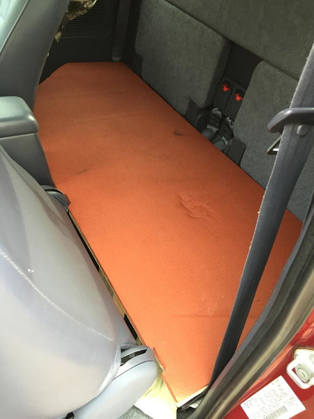

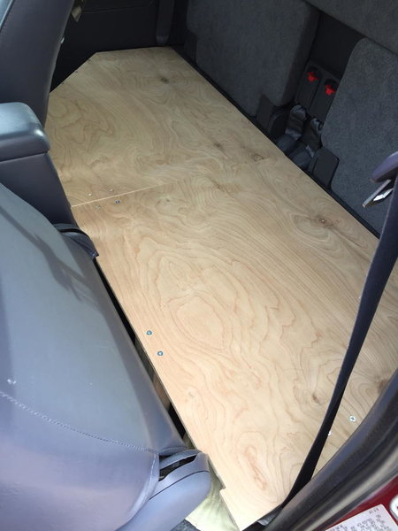

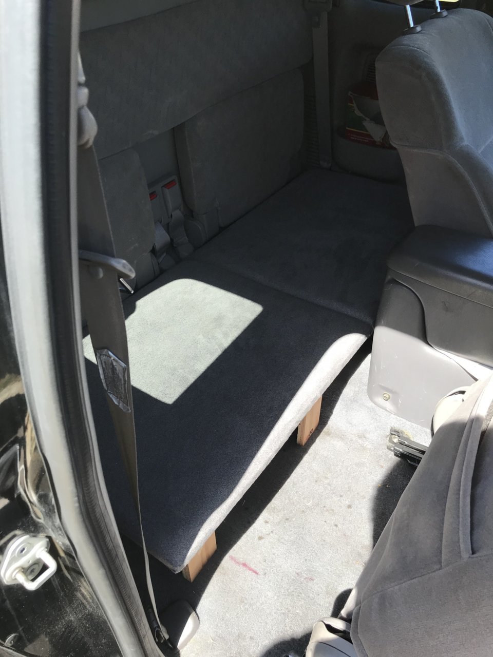

    Here's a couple pictures - pretty much the same you did with a small change.
    #1 driver side, platform in place. I used 1/2 inch birch laminate plywood. Home Depot had it cheap and it was nice and straight.
    #2 I had an old foam camping sleeping mat I no longer needed - I cut that to fit on the platform in place. Gives Rocco a grippy texture to hang on to, and since it's padded, it's more comfortable than the wood alone.
    #3 driver side with the mat in place

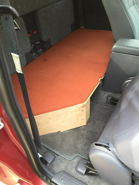

    #4 is the passenger side, and the only change I made from Matt's design was to notch out the corner, it allows him to use the truck floor as a step up to the platform.
    Rocco is a 5 year old all black German Shepherd. He was 106lbs at the last visit to the vet, so I had some concern it may not be big enough for him, but it works out well, and he really likes it.
    Rocco and the truck pictured this past winter.
    Planned - I'm going to get some spring clips at the hardware store and attach them to the bottom of the platform to attach an entrenching tool, axe, and hand saw. They'll be out of the way, keep them from rolling around, and they'll be handy when I need them.
    As Matt pointed out, it's easily removed if you need the space, but I intend to pretty much leave it in place. Best mod I've done to the truck so far, and a cheap one at that.

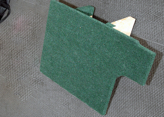

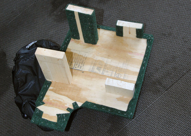

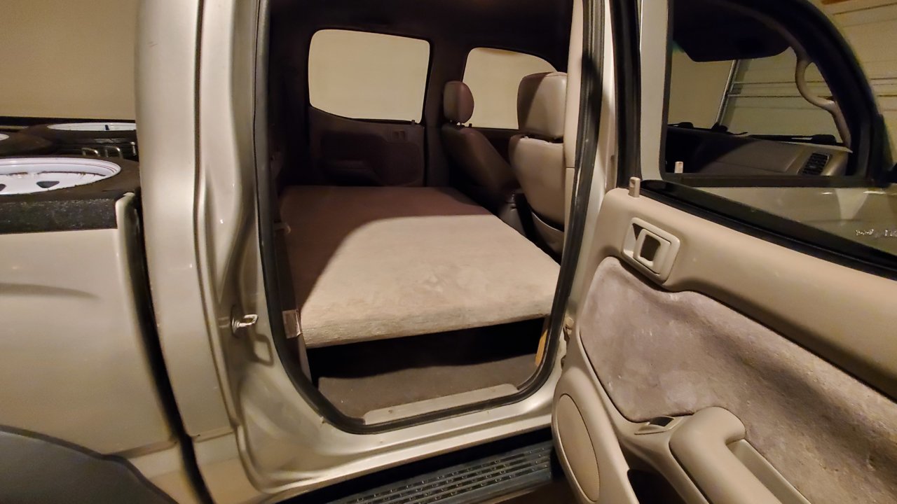

    I built this a few months back when driving across 4 states for my doggos.
    Built with 3/4" plywood, 2x4, 3" memory foam, and color match upholstery from craft store.
