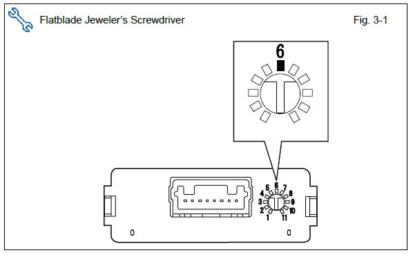

    Find out what alarm is installed, (call, visit dealer). It might have something similar to this to adjust.
    GreyBaldTaco and dilbert like this.

    Thanks Caribe Makaira (and, uh, everyone else for their contributions! :)). Can you please give me an approx area where this dial might be located? I'm struggling to find it via web. Thanks.

    Without knowing what alarm system with glass sensor the Tacoma has, it's a guess. Can be behind the glovebox or under dash in drivers side...

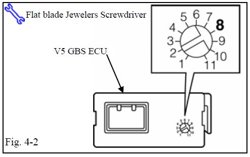

    if it’s the Toyota OEM it doesn’t have that dial. You can disable the glass break sensor by unplugging it, or by disabling it with Techstream, both will still leave the alarm enabled for other functions. The glass break sensor is behind the drivers side kick panel. If you google “Tacoma 2016 glass break sensor install pdf” you’ll see where / how it’s installed and simply reverse to disable.
    The hammer likes this.
