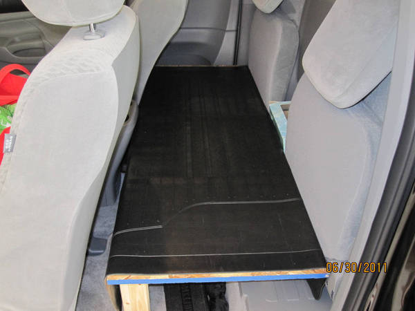

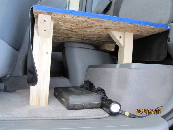

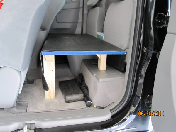

    I tried taking the dog for a ride around town the other day and being a lab made it very difficult for her to get comfortable. So I made a quick and easy shelf for her to use and I like it so much I am going to make it look a little better so it can be in there all the time and not look like a jalopy (sp?).
    I am also curious as to how many other people have one of these so I made a poll. I did a search and saw some posts about the shelf but no polls.
    I made it out of some chip board (18"x48") and 2x3s with some 45 degree blocks for support. I chose the 18" based on where my wife had her seat pushed back to and it just so happens that the edge of the shelf fits perfectly up against the back of the front console. So I guess 18" is the max you could go. I also fold up my seats and the shelf sits right on top of the back center console and I have a 2x3 on the back edge of the shelf to help support it as well. It really doesn't need it though but it will be handy when I make a flip top section that allows me to access the center console back there without taking the whole thing out.
    Right now I have one of those thin rubber trunk mats from WalMart ($15) to cover it. It is a little short side to side by an inch but it works for now. I throw the dog's blanket back there so she has something comfortable to lay on and she loves it. I plan to either paint it or cover it with the auto carpet from WalMart like one of the other guys in the forum did to his. As this evolves, I will post pics to hopefully help others, get me some feedback on how to make it better, and to inspire others to do the same. Right now, I have about $25 invested in it and that includes the mat. The carpeting was cheaper than the mat but I figured the mat would be easier to clean than the carpet.

    thats nice man. btw i did not vote. i have DC. did you even think about making some drawer thats in the floor board part that you can pull out and have easy accesses to stuff and it be save in the truck.? if i had AC and did the thats something i would do.

    That did cross my mind for a future build as I figured out what I would put under there. If I made a drawer though, I would have to remove the shelf to get at the little storage boxes that are under the seat. I am still trying to think about how to do the drawers and still be able to use the storage boxes too.

    Yeah, now that I look at my pic, I could make something that took up that whole space and slides out. That is a great idea and it will keep things from being shoved up under there and getting lost under the seats.
