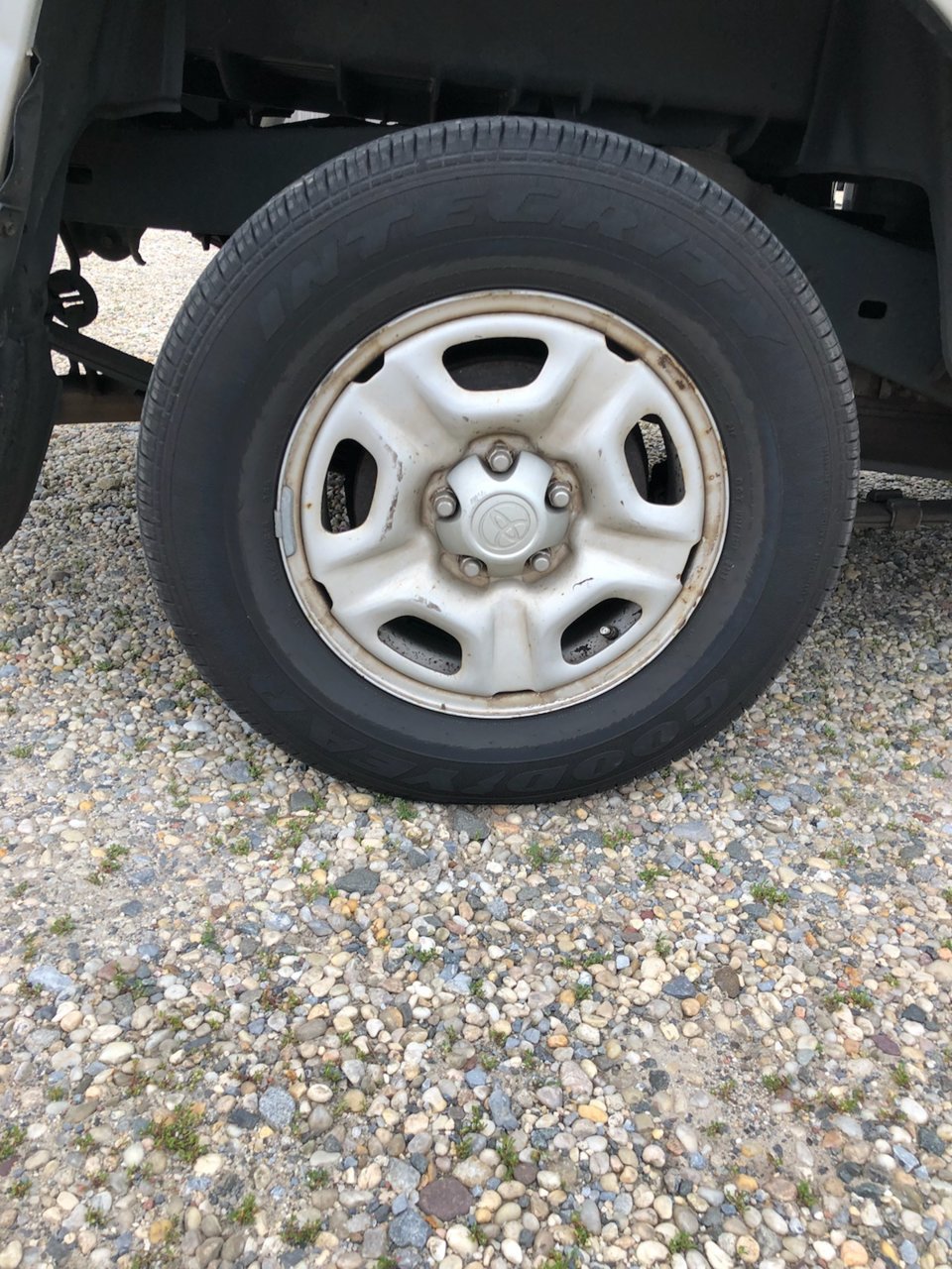

    So, I thought I searched and found out what type of rims were needed for my 2008 Tacoma, base model (2wd)...
    I ordered 4 rims,
    American Racing Custom Wheels AR172 Baja Satin Black Wheel (15x7"/5x114.3mm, 6mm offset)
    Mechanic called today (Just after my new frame install!!!) saying the front rims are binding on the calipers...
    Im sure everyone understands wheel measurements better than me, but can anyone let me know if I can add a spacer, if so what thickness and may be link me to the exact part ?
    Did I totally screw this up, and need to return them ?
    Afraid I will make another mistake that costs even more...
    Update, I just double checked the American Racing web site, and the site says I did buy the right part... now even more confused...
    Thanks!!!!

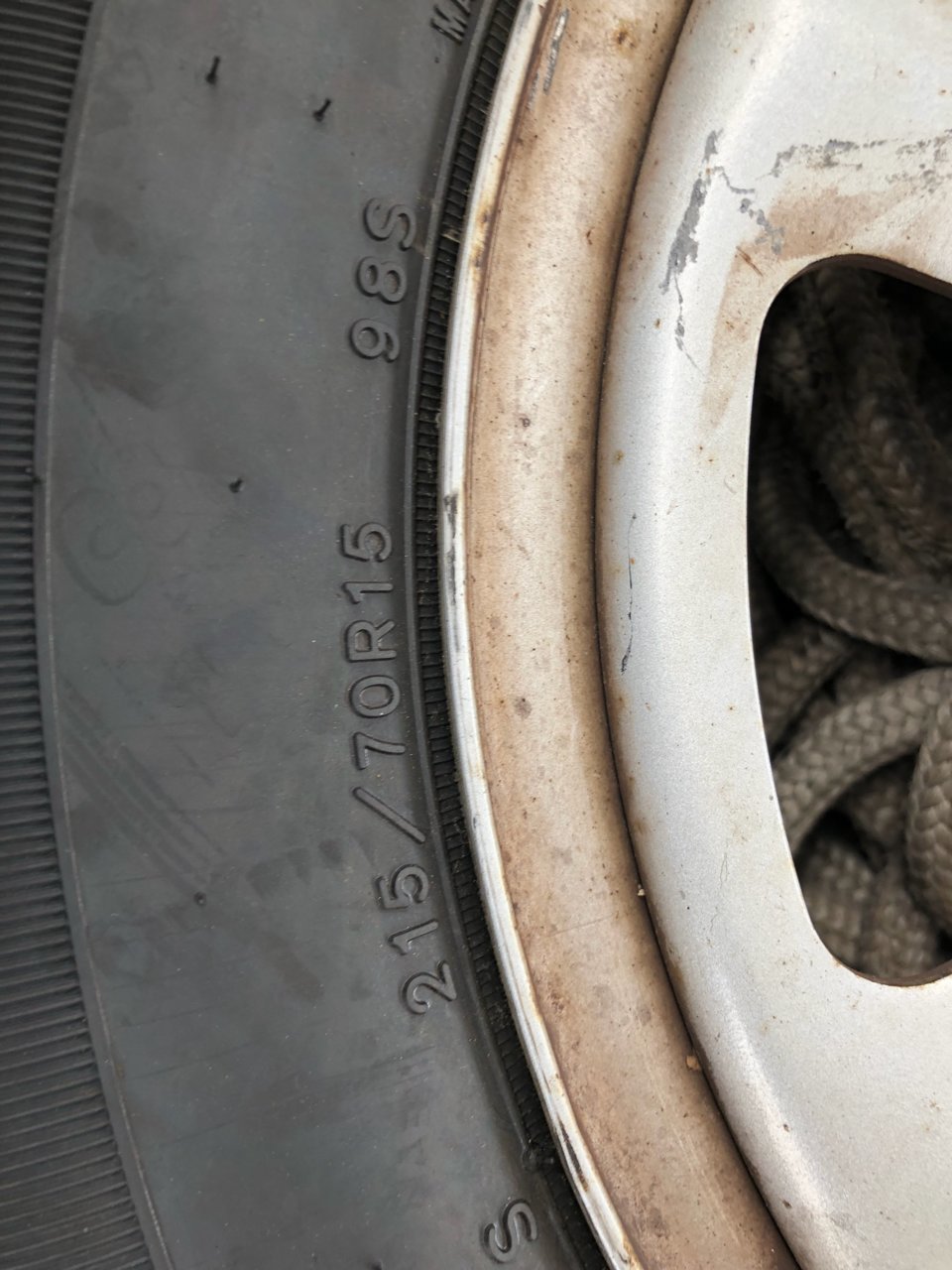

    I thought the 2nd gen tacoma's came with 16" wheels not 15"

    Stock wheels are indeed 16" on 2nd Gen.

    Well if OP bought 15" wheels then I guess that would explain why the wheels hit the caliper's on the front

    Do you know how the wheel is binding? If it is rubbing the face of the caliper a wheel spacer will fix the issue. If it is rubbing the inside of the wheel from the top or bottom of the caliper you need different wheels.

    It's a 5 lug so it has 15's stock
    We all assumed it was a 6 lug op.
    You should be ok to fit with what you purchased.

    If it is rubbing the face of the caliper it is an easy fix. Some small wheel spacers will take care of the problem. A lot of the time just the wheel offset and backspacing seem appropriate the concave of the wheel will mess it all up. It's a common issue on cars running deep/wide wheels. Good luck OP, these little issues are always a PITA.

    http://www.toyodiy.com/parts/p_U_200805_TOYOTA_TACOMA_TRN220L-TRPDKA_4103.html
    Shows,
    42601-AD02015X6J, TIRE & DISC WHEEL-P215/70R15 6J+45 STEEL, TYPE B:REFER ILLUST.
    I know 6J is the wheel type, and 6JJ is the one I dont have...
    But is the +45 the offset ????? If not what is it ?
    EDIT: Looks like 35MM from a few quick searches... Guess I have to rope the kid down for an hour to get to the bottom of this...
