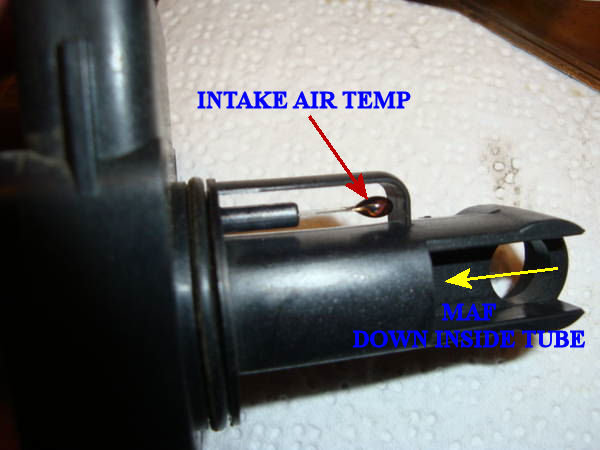

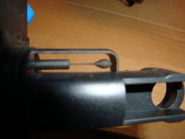

    Use the stock Denso plugs K16TR11 with the dual electrode. The 5VZFE needs these. Also check the gaps before you leave the store. I've rejected 2 out of 6 before because the electrodes were bent out of alignment (not just gap, but off-axis). All the others were dead on spec when gauged.

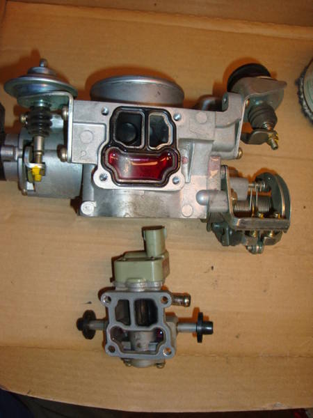

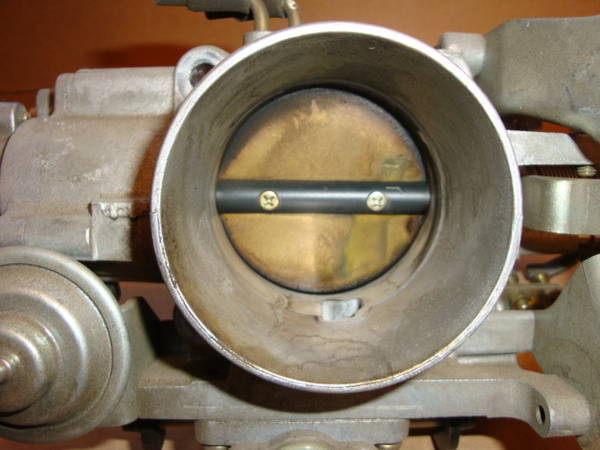

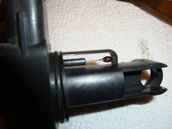

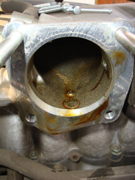

    Consider cleaning your MAF and the TB too. Remove the intake tube and look inside. If the butterfly is grungy, pull off the TB and give it a good benchtop cleaning (inlcuding the IAC underneath) and get a new crush gasket; it is not reusable.
    Dirty MAF
    Clean MAF
    TB dirty from intake side (this isn't too bad compared to others)
    TB dirty from manifold side

    TB with IAC off

    That is the intake air temp sensor.
    The MAF is way down inside the plastic tube.

    What the hell. I guess I was misled. Thanks for clarifying.

    AAAWWW man I've been cleaning the wrong sensor. I didn't know the sensor was down in the tube.
