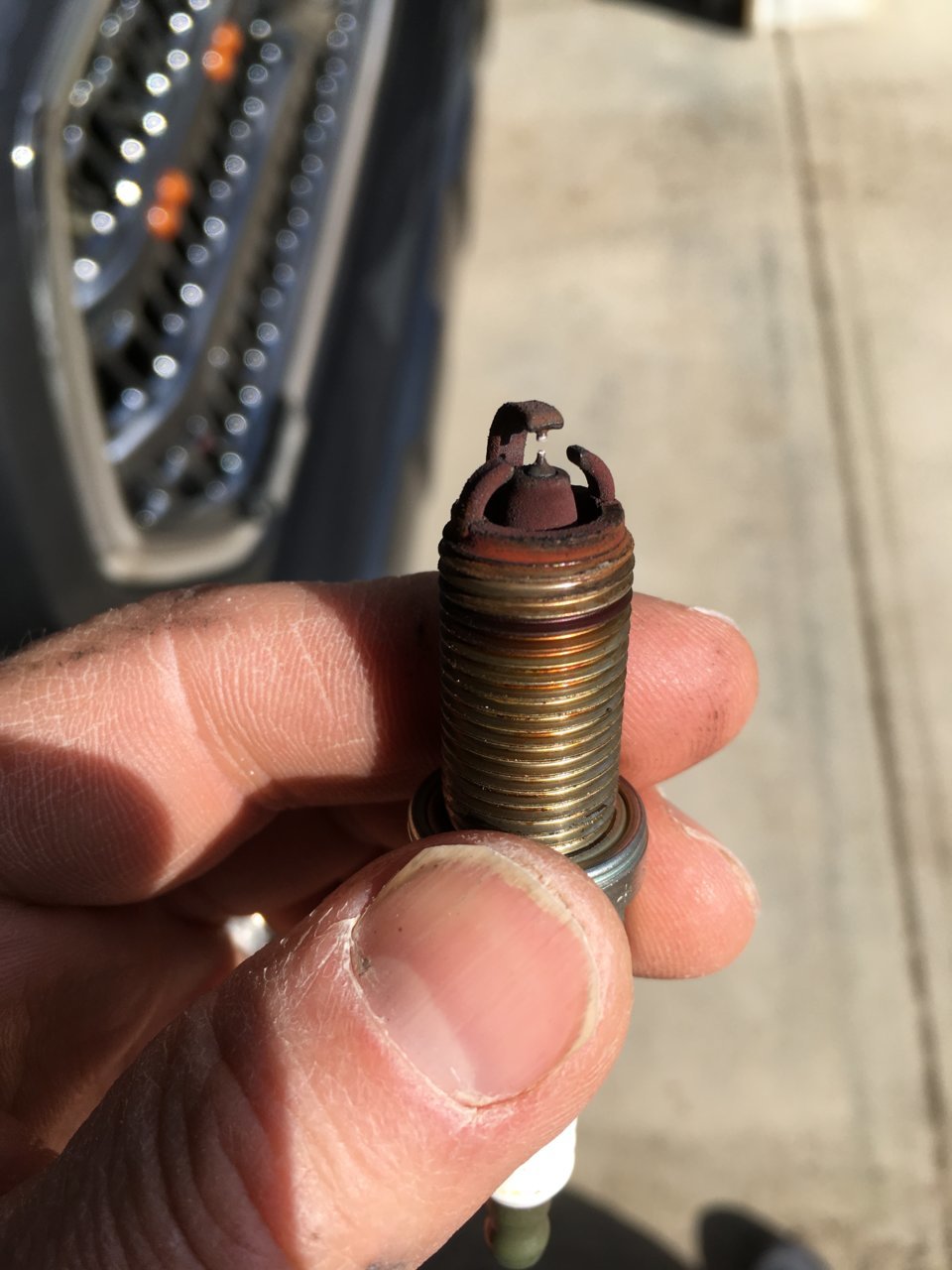

    8FBEA9EB-14DD-45F7-9C98-B1BCD4D624D9.jpg A756BC6D-C6E1-4E03-B53C-35BC7F16A055.jpg About a hundred years ago being 6 years old and living in Nebraska, my ol’ man, a travelling sales man, and I were cruising on down the highway and he looked at me and ask, “do you want to drive?” Recovering from the shock and awe of that, I said “HELL YA”!! (Well, maybe it was more like, ‘are you sure, is it legal, will we get in trouble?...’), and from that time on my dad made sure I sat on his lap and steered the vehicle straight down the road and when I was tall enough to reach the peddles, I was sitting next to him completely driving the car. I loved the classic cars and was always under the hood poking around with tune-ups or underneath doing the oil changes. I had a good knowledge of basic maintenance, swapping out tires and that was about as far as I wanted to take my mechanical experience.
    Now, jumping ahead many years, I drive a 2017 tacoma and I still love doing maintenance myself, research and critical thinking and buying tools is fun and to some degree, keeps me in trouble.
    Having bought the truck in 2017, my service department made the choice for me to do more on my own vehicle myself, easy like at 13k finding out all the oil levels in diff’s and transmission were low and not checked during the PDI.
    As of late, my interest has been to research spark plugs and inquire into what my truck is running. The book says replace plugs with DENSO and provides a number and what the gap is. A small warning notation below says if using iridium plugs, DONT MESS WITH THE GAP.
    Ok then, I’ve got 70,000kms on the truck and I decided I would simply swap out the plugs for a new set from the dealer but here is where things got confusing. Firstly, if Toyota doesn’t want you messing around with stuff, they won’t give you the information to mess around with it! (We’ll come back to this point)
    I walk in to the parts department and say, ‘I want a set of plugs but the book gives me a choice of DENSO or iridium. Denso’s I can gap and iridium’s I can’t.’ Parts guy says they only sell Iridium plugs @ $30 each so I figured I’d just shop around. He also said these plugs last till 180,000kms so I shouldn’t bother replacing now. I then walked into the service department and asked the service advisor about the two types of plugs mention in my book. The advisor said DENSO plugs are changed at 50,000kms and are for older models and iridium plugs are standard on the new ones and changed at 180k kms. I said I’ve got 70k on my odometer so if I’m running DENSO plugs, IM A BIT LATE ON SERVICING THEM! What plugs do I have?? The advisor looked on the screen and was unable to tell me! So, I went home and pulled one myself. Lo and behold, wouldn’t I see that I am running DENSO Iridium plugs. So what’s confusing is that in the book, it shows the DENSO plug with the number ID that matched what I pulled and what the gap should be. Below that is the warning that if I’m going with Iridiums, DONT TOUCH THE GAP. Anyway, I just soaked the plugs and brushed them clean and put them back in. Searching online for iridium plugs, I wasn’t expecting to see 3
    prong plugs so something else to look into...

    I've Never seen a plug with an electrode coming down from the top prong like that....

    It's actually quite common. Even those with the traditional single ground strap (the top prong), you can look close and often see a small cylindrical shape there. With iridium plugs, you generally have something similar to what you see in the OPs picture short of the multiple ground straps.
    For the OP, yup lots of people that work in that environment don't know really what they are looking at. I would like to have seen your plugs after cleaning though.... that picture appears to have the iridium tip slightly eroded. Also, the plug change is to maintain your emissions warranty.... At least in the US.

    I should have taken a pic after cleaning. Was definitely gentle with the brush at the actual tip as to not mess with the gap. I found out a bit later after the good folks (parts dept) at Toyota dealership told me that the iridium plugs are changed out at 180,000kms and, (service advisor) change out is either 50,000kms for “older models” and 180,000kms for newer but then didn’t know what the 2017 was using... I checked with Toyota Canada website for service schedule on the iridiums and they list changing them at 96,000kms or 60,000 miles. (That actually makes sense

    110k is a long time on a set of plugs. I would swap them out, but get them from Napa or O'Reilly. Probably $7 each. Iridium plugs come pre-gapped because it's easy to mess up the electrode when gapping them.
