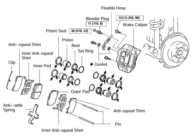

    Keeper pin was the wrong word. I was trying to describe the tiny thing that goes in both of the pins so they don't come out. The FSM calls it a "Clip":

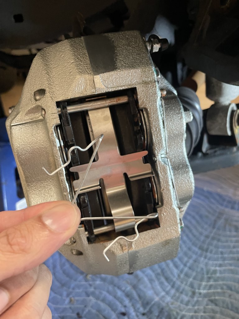

    my brake pads came with 2 different types of clips (4 in total) I'm just using the two of them tho (the ones described in ur graphic) as thats what I've seen in all the tutorials.
    will leave these ones out
    the other pins look like this: IMG_0198.jpg
    Black97v6MT likes this.
