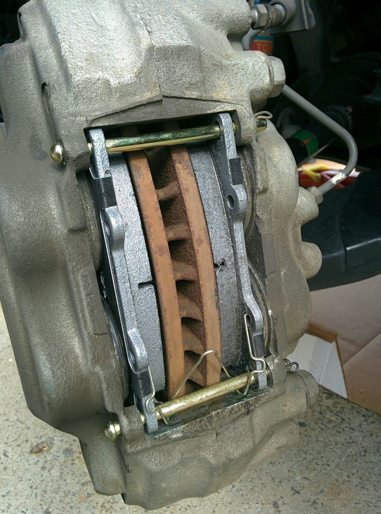

    That M shaped spring goes onto one pin on Tundra calipers. It uses that M style spring instead of that larger, flat anti-rattle spring in between your calipers in the picture. Pic is a rando from the web.
