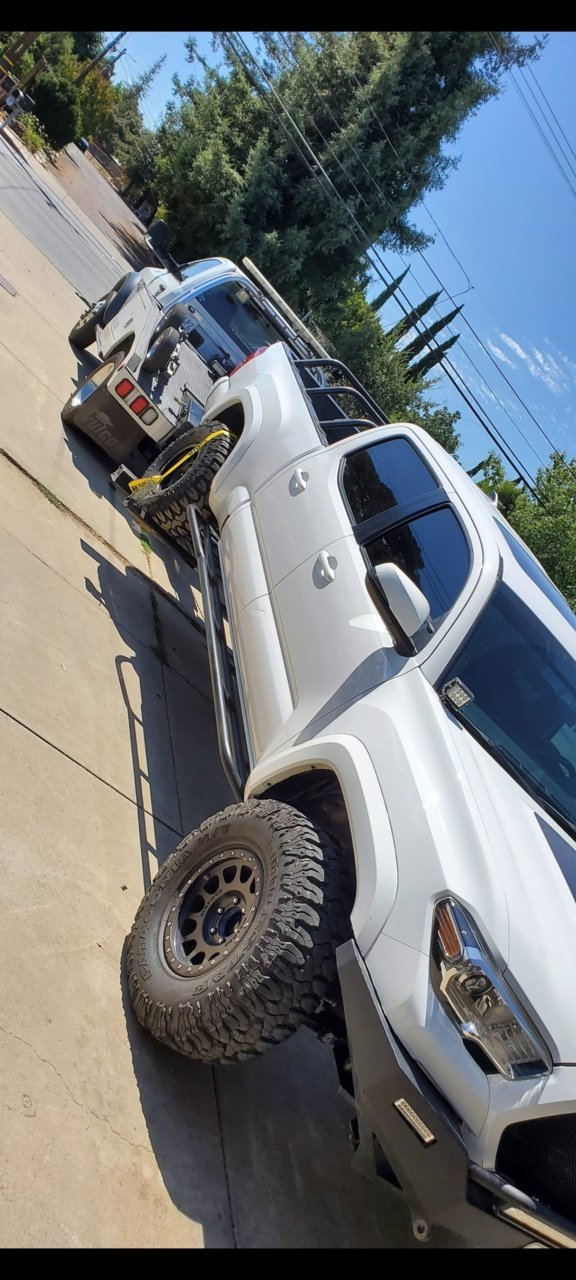

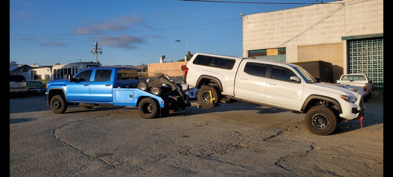

    Few pics a few years apart. Zero issues Screenshot_20230120_133041_Photos.jpg Screenshot_20230120_132826_Photos.jpg
