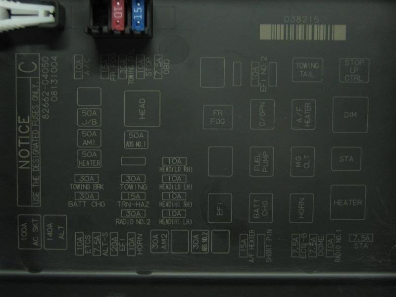

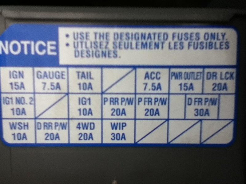

    Dome 7.5A in the engine bay. Right side bottom of the picture.

    On a 14, I believe it is the top row, 2 or 3 from the right, 15 amp fuse for the plugs in the cab panel. Don't know offhand for the lights but check the switch as mentioned above.
