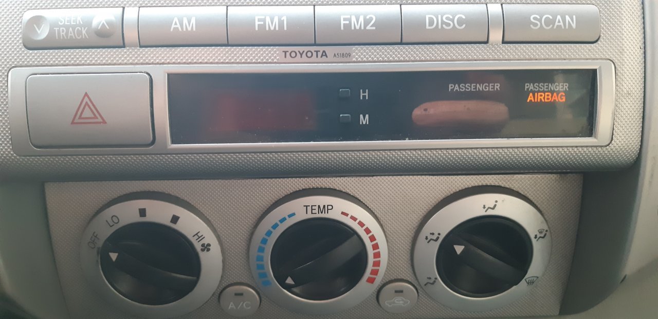

    Is it possible for my dome light to be shorting out and causing other systems to have power with the key off?
    This is what I'm dealing with - a few weeks ago I loaned the truck to a co-worker who accidentally left my led light bar switched on and drained the battery. I've only had the truck a couple months and the previous owner put a new battery in before I picked it up so possibly this issue goes back further than that. Since then however the truck would randomly die whether it was parked more than a few hours, to the point where I was disconnecting the battery every night and each day at work to keep it from discharging (yesterday I broke down and bought a battery charger/maintainer) Also, whatever was going on with it, my power windows would work with the key off even after opening the door and waiting 30 second or whatever, the key fob would not work, the heater fan would keep running after turning the keys off but if turned off with the switch would not turn back on until the keys were on again and the passenger airbag light would stay on or flicker like this:20190506_200035.jpg
    Anyway, tonight I was waiting for my kid and I turned the dome light on (I've had it turned off, not even on door since the first time the battery died by itself) well the airbag light goes out, my windows lose power as soon as I open the door (like they should) and my key fob works again. I'm at a loss. I'd like to think it was just the dome light switch but I'm afraid to leave it overnight in case it drains again. Has anybody else experienced a similar issue? (Has anybody managed to read this far?) A different guy at work reckons the ignition switch might be faulty and I've ordered a new one but tonight's experience makes me think that might not be it.

    Update , just went out to the truck and it wouldn't unlock with the key fob again. Jumped in and sure enough, airbag light is on. So not the dome light switch itself but something connected? Unless that was just a coincidence. Either way, back to square one.
    Another clue, heater fan will stay running if on but won't turn on with keys off. Recirc button however lights up if pressed with keys off and can hear door cycle. Another thread talked about fan motor, maybe I should check that out.

    I'm back to ignition. There's a spot on the ignition switch past "Acc" but before "On" where that airbag light comes on properly, not just dim and flickering like it is with the keys off. Just went and tried it now and the blower motor will turn on at that point too. Something must be loose inside the switch and making contact where it's not supposed to. Not sure why the blower motor stays on but won't turn back on when the keys are off but since I've already ordered a new ignition switch, may as well try replacing it before I go any further.
