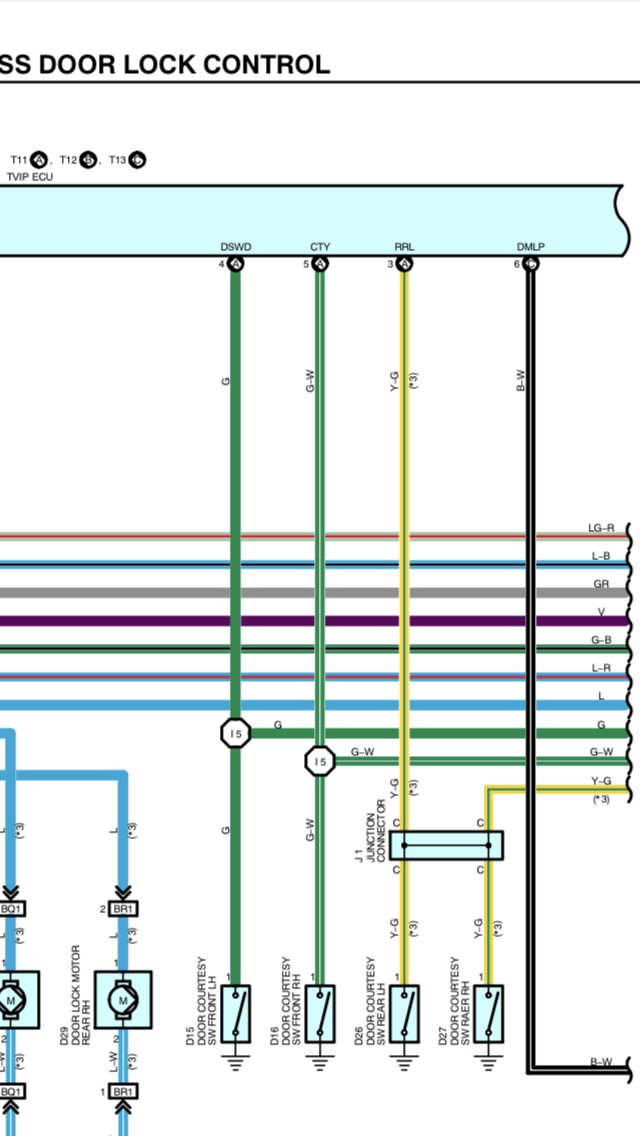

    So i'ts been almost a month and I still haven't resolved this issue. Wiring all rings out good with a multimeter, the dome light switch is good, it even turns on in the door position when the key fob is used (via the TVIP ECU, it shares the black and white wire that goes to the body ECU for the door switches) to unlock the vehicle, which tells me that everything from the fuse junction block all the way to the body ECU is good, and my problem lies at the body ECU, or possibly but very unlikely all four door switches, which appear to be working with a multimeter. I have tried reseting it by disconnecting the battery and waiting 15 minutes with no luck. Anyone else reach this point and find a solution other than a new body ECU? Also, would a dealership be able to run a diagnostic on the ECU to detect an internal fault with the dome light door switch circuit? I don't know what else it could be, and at this point, I've pretty much resigned to either not having a door activated dome light, or deleting the wire that goes into the ECU and taking it directly to the door switches. Y'alls input is greatly appreciated.

    The switch has to be good, the light turns on when in the DOOR position if unlocked with the key fob. As per the wiring diagram, this means it is grounding via the black and white wire that runs off of the DOOR side of the dome switch, and splits going to both the body ECU, and the TVIP ECU. In the case of being unlocked by the key fob, it’s getting its ground from the TVIP ECU. For whatever reason, it’s not getting a ground from the body ECU/door switches.

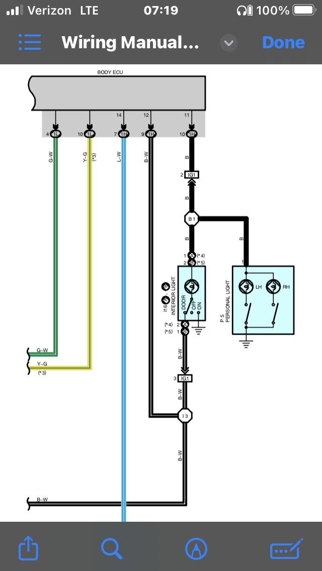

    Has anybody back probed the connector for the door switches where it connects to the body ECU, and if so, does anyone know if you are supposed to get 12 volts there? Or is it a lower voltage that just passes the signal to the ECU to ground it elsewhere?

    I'd back prob the ECU door switch pins.
    Open and close the doors and see if the ECU is being pulled to ground.
    If not, there is issues in the wiring to the ECU.
    If not, then the ECU isn't working "right".

    Typically, in these case. The wire will voltage on it when the door is closed (Switch open / Door Closed).
    When the door opens, the switch closes, and the wire at the ECU should go to 0v-1v.
    Basically, when the ECU see a ground connection, it supplies a ground to the light.

    Okay, didn’t know that. So the door switches do not complete the circuit, they merely send a signal to the ECU which then grounds it from the white and black wire shown bottom right of the diagram?

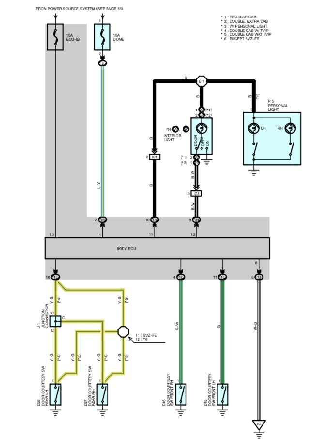

    Door switch wires back probed at the connector (1L) read 0 volts with doors open, and .3-.4 volts doors closed.

    0v is right with door(s) open.
    BUT...... .3/.5v is not right.
    It should be about 5v-5.5v
    So lets clear things up.
    1. When the switch is set to ON, the ground is supplied by one of the screws for the switch.
    2. When the switch is set to DOOR, the ground is supplied by the Body ECU @ the 1H Connector - Pin #9.
    3. It passes through the IG1 Connector at pin #3 before it gets to the body ECU.
    So, Have we checked the ground at the BODY ECU 1H Pin #9 or the IG1 pin #3?
    Also, still confused at the .3/.5v as that is low.
    But we need to see if the ECU is even providing a ground.
    Obviously, you'll want to have to have the doors open when testing.
    You might even supply your own ground to the 1L Door Switch pin just make good and sure the ECU has a good ground at the pin.
