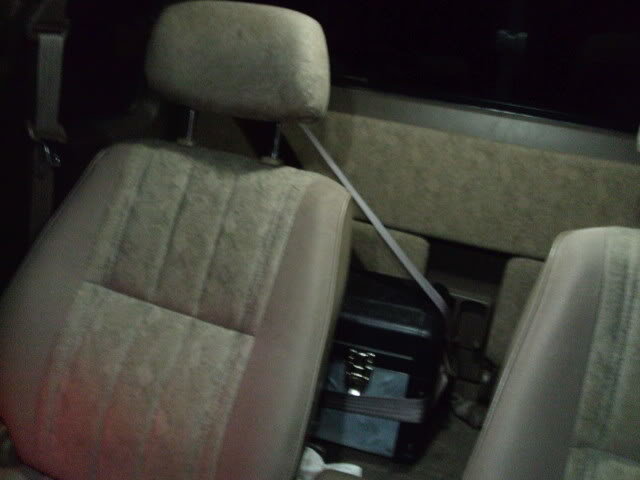

    Seemed pretty normal when I opened the door tonight...
    But then anything is better than 1st gen OEM...
