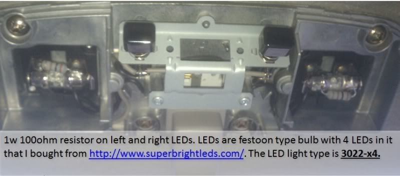

    Sorry for the late response on the pics. Hope this helps at least one person because I almost went insane trying to figure out this issue.

    I did the same thing, only useing the old bulbs as my resistor.

    Here's the fix for my 2004 Tacoma DC.
    I added 2 - 100 ohm 1 Watt resistors to my dome light bulb (similarly to pictures above) and each map light bulb and they worked perfectly. Neither would come on with just 1 resistor on them!!! I read somewhere that someone got them to work with just 1 resistor on each bulb, but I had to use two n each to get them to work...
    Got the resistors at Radio Shack, they were 2 for $1.50. :)

    did this today and it works perfectly! thanks
    and thanks otoball for the pics :)

    I have no idea what the deal is with my 04 taco but it did not like a festoon bulb with a 1W 100ohm resistor soldered to it. As soon as I put it in the dome it blew the interior lighting fuse.
    At first I thought I just blew up the bulb somehow but then I went to drive to autozone for a new trailer hitch pin and realized my radio would not turn on.
    Then long story short I had extra fuses and replaced the blown one, and now instead of flickering when keys are not in the ignition, the bulbs are on full as normal. Weird. Maybe the fuse that was in was just old or going bad, idk.

    I added the resistor to begin with which is what I believe shorted it. I think what happened was like you said, the resistor made contact with the ground. I did a stupidly hurried soldering job and some of the solder got bulked up towards the ends where contact is made, so I'm guessing this is the same as direct contact.
    Either way for whatever reason, now WITH the resistor removed from the dome bulb and the fuse having been replaced, the lights all work as they should/no flickering. Even the MAP lights, which I did nothing to whatsoever.

    Yeah, I don't get it. Thankfully, the resistors worked. (My setup looks almost identical to otoball's.)

    I only need one 1watt 100ohm resistor on the dome light and everything works fine for me on my 04 tacoma.
