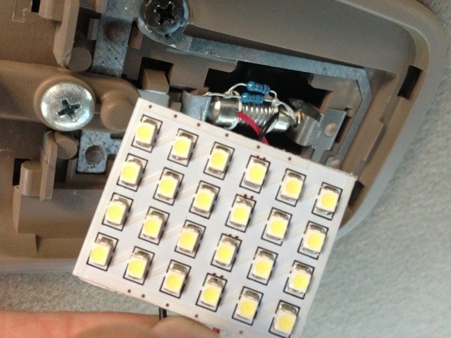

    I have an '03 DC Tacoma and using a panel LED for my dome light which requires (2) 100 ohm resistors in parallel to allow the LED light to stay on when the doors are open.
    0af6cdce-9dc2-4b16-a9e7-7cf866d4f1e4_zps_1d264384ab377e8f8cd2f80a68b9911958375b00.jpg
    With only (1) 100 ohm resistor, the LED dome light would stay on when unarmed, but go off once the door was opened (even though it was set to the DOOR mode). Turning on one of the map lights with OEM bulbs for now triggered the LED dome light to turn on/off.
    Thanks to Scott from post above for his help!
    NOTE:
    I purchased the 1/4 Watt 100 Ohm resistors from my local Fry's Electronics. They had the 1/8 watt ones, but they looked too small to dissipate heat. Hopefully my 1/4 watt resistors won't overheat and melt any wires as compared to the 1 watt Radio Shack resistors that everyone has been using. If anyone thinks that my 1/4 watt resistors are too low of a rating, let me know and I'll head down to the 'shack and pick up the 1 watters.
