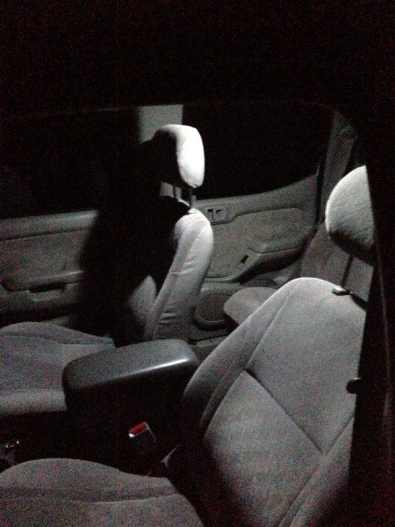

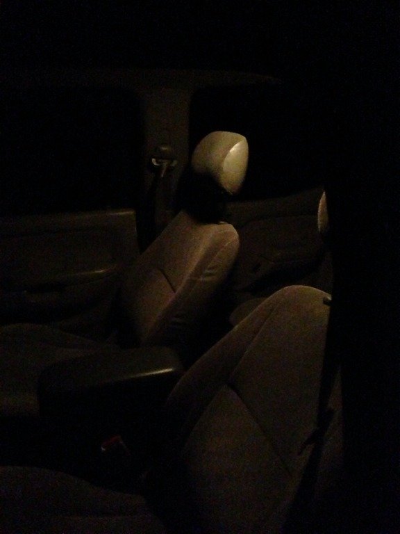

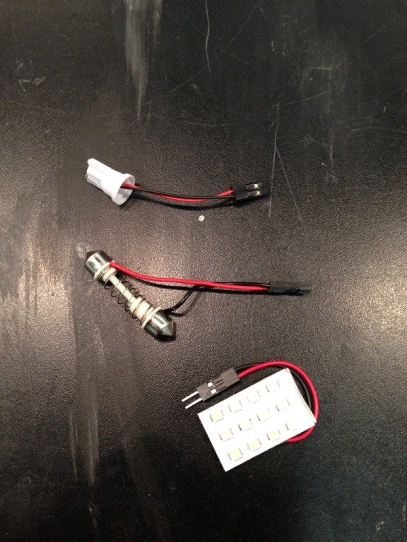

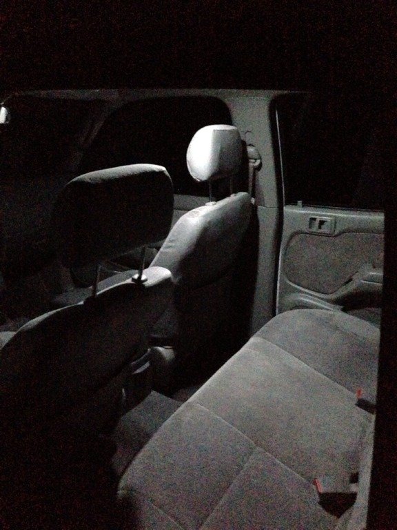

    Here's my experience with the Ebay one. As mentioned you will need the resistors for 2001 on and I have a 2002.

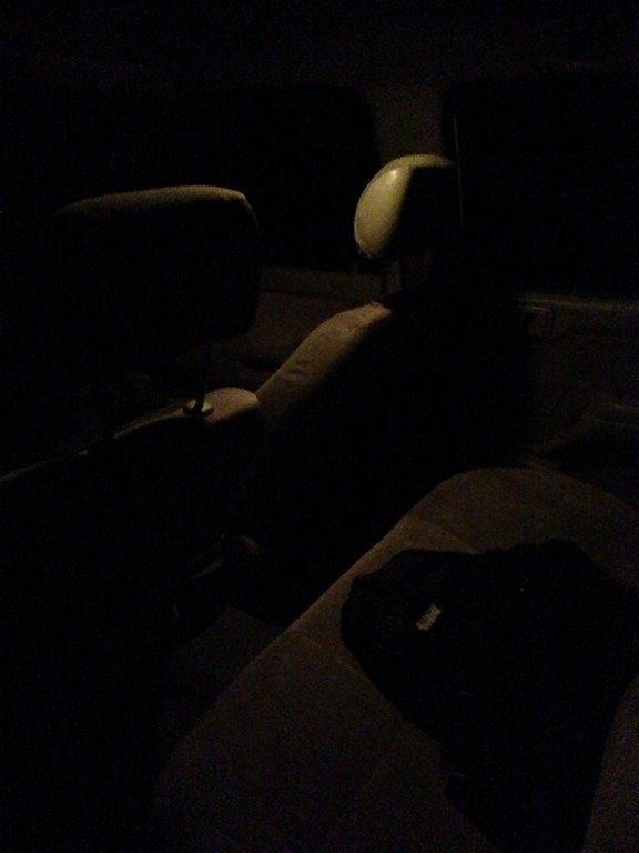

    Here's my lameness in stock mode.
    71F7DF80-2F40-4061-BDF4-CC4B896C9E86-116_6aff8af0901c76373ac5d72a4bf890e3e18d36c4.jpg
    BC6F2E0A-A87F-445A-BAC1-B43FFF6FE337-116_ebcc9980cd928d649ab7d1510a67ea2d429d49f9.jpg

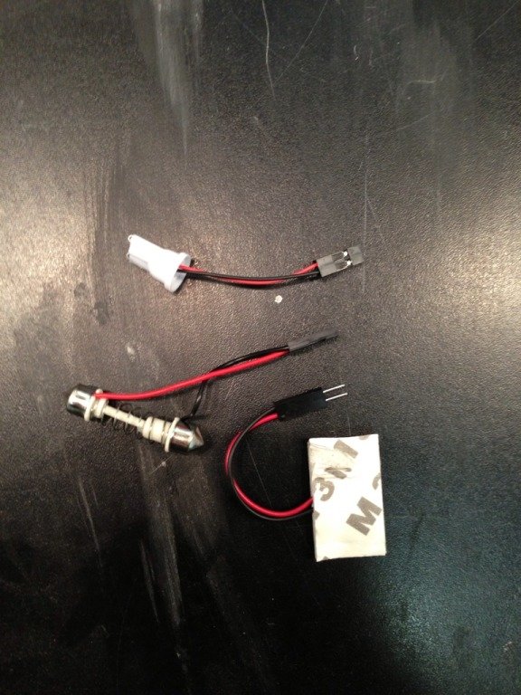

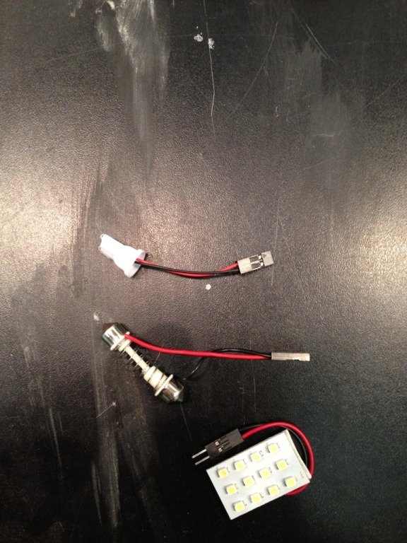

    Here's what came in the mail.
    C6C80669-FF6B-4F57-867C-25DC4FFA3765-116_9f44795bb2ab4994300b2d64e240d620c2dbb546.jpg
    DAD29A1C-7803-47CC-9D63-AAC5C07D814D-116_47629b7e909eed95b4c2b95060b4444b4f342a7b.jpg
    1117C103-7C7E-404F-9FCA-7EB82983D71B-116_5ece47d611ba9127ed3a960e68ececcfc3cb3cb6.jpg

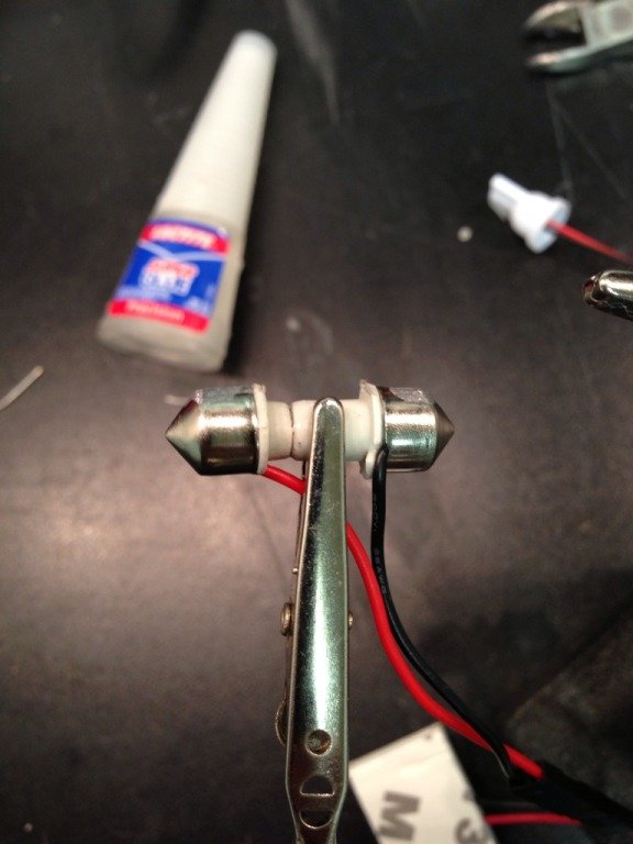

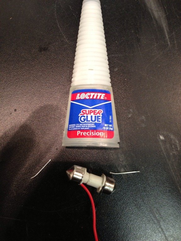

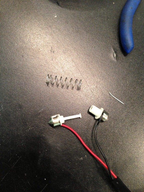

    After some trial and error I took out this spring because it was pissing me off and PITA to fit. Since the bulb size is equal to this thing fully compressed I just super glued the 2 halves together.
    79CED2CD-87D7-4788-BB35-E784CB6C4ECC-116_6dc7a877e11062b6863af5721d0ab34e5b6e311d.jpg
    C95B7985-9D19-4B7C-904E-F7D3C75A2045-116_91117062aac917b0b631c7786bb7e97367bc3ff8.jpg

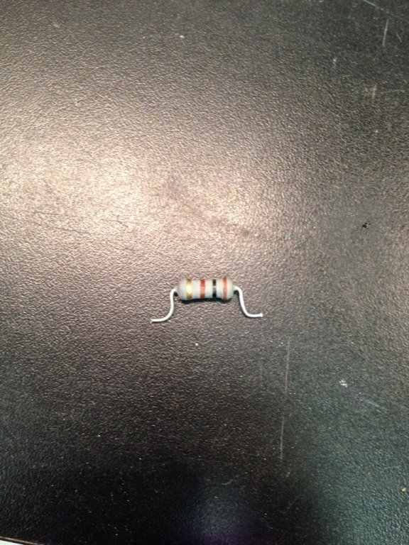

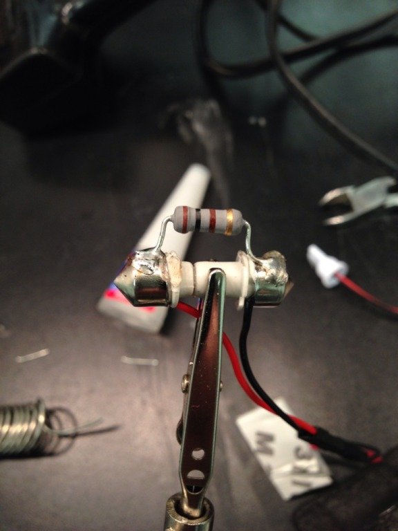

    I dremeled each end to get a good surface for the solder and then cut off the ends of the resistor to fit. Soldered it together.
    BA2A8C4C-54DC-4FD4-9BEF-54E327B27A75-116_1fed16ed5c581bf9d4ca1dd7c0a858737fcad810.jpg
    ADD7F551-DBA2-4571-B25C-3E48B3BD83E4-116_aaf546755f9f43604314249fc48f2d52cb553648.jpg
    C40F9D68-656F-408D-A46D-D0B2D4CBA124-116_feb3ec2b3bc8a07c7a530dc14b9791eb8fd55cf5.jpg
    The soldering iron was getting tricky and HOT to the point where it started to melt the plastic center piece, this lead to the wire ends melting into the plastic and I lost my electrical connection.

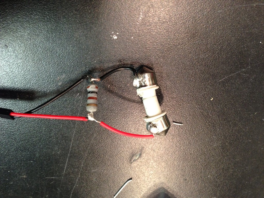

    So... I had to go a different route, I soldered the wire ends back to the metal caps, continued to use the melted plastic piece, and then put the resistor between the 2 wires instead. This worked for me but that resistor gets pretty freakin hot... is it hotter than the old incandescent bulb only time will tell. I taped it off with electrical tape.
    AD44517B-F930-42F3-A11F-E6266367315B-116_4927f465bacb128321678d662de119366168736b.jpg
    I coiled up the wire and did my best to center the led's, took off the 3M backing and stuck it in as best I could considering there's not much of a flat surface in the center.
    Here's the AFTER pics.
    F5C2E651-D56D-4C36-B30D-9D3C2FB834EF-116_3d25174f43b37804a44dfcebce5089730802eb74.jpg
    4CD6A7BE-B7F4-4461-B45B-71642221DB65-116_89ae037f18d195444b0cfebb2ba2d4884181c98f.jpg
    Nice and bright. If I get time I might just try one of those with the LED's inbetween the contact ends for comparison.

    If you use a heat sink where you are soldering, you won't melt the plastic like that. Heat conducts very well in metal, so attach the alligator clip (or pliers... or vise) to the metal festoon cap where you are soldering, make sure it is touching the metal but out of the way of your solder joint. The heat will dissipate into the metal and probably save the plastic.
