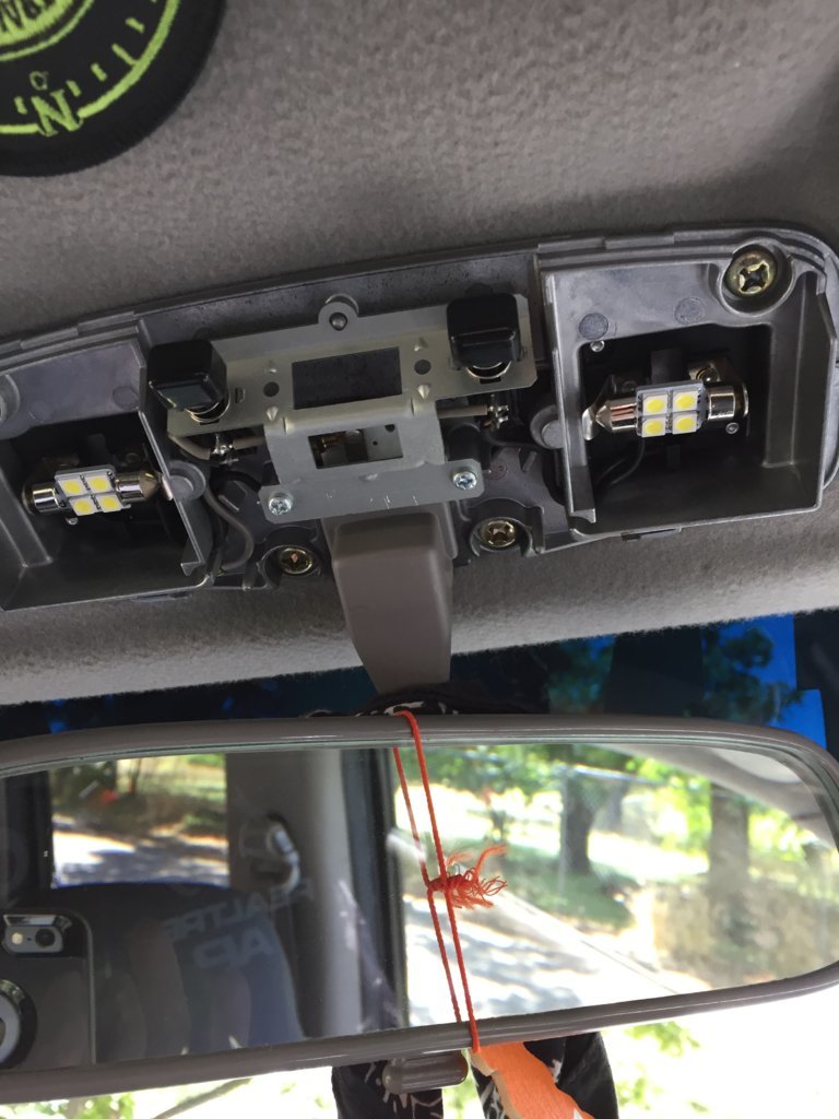

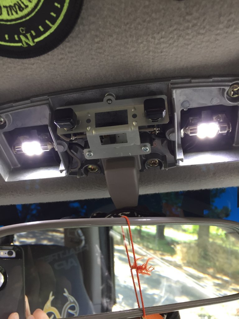

    For reference.

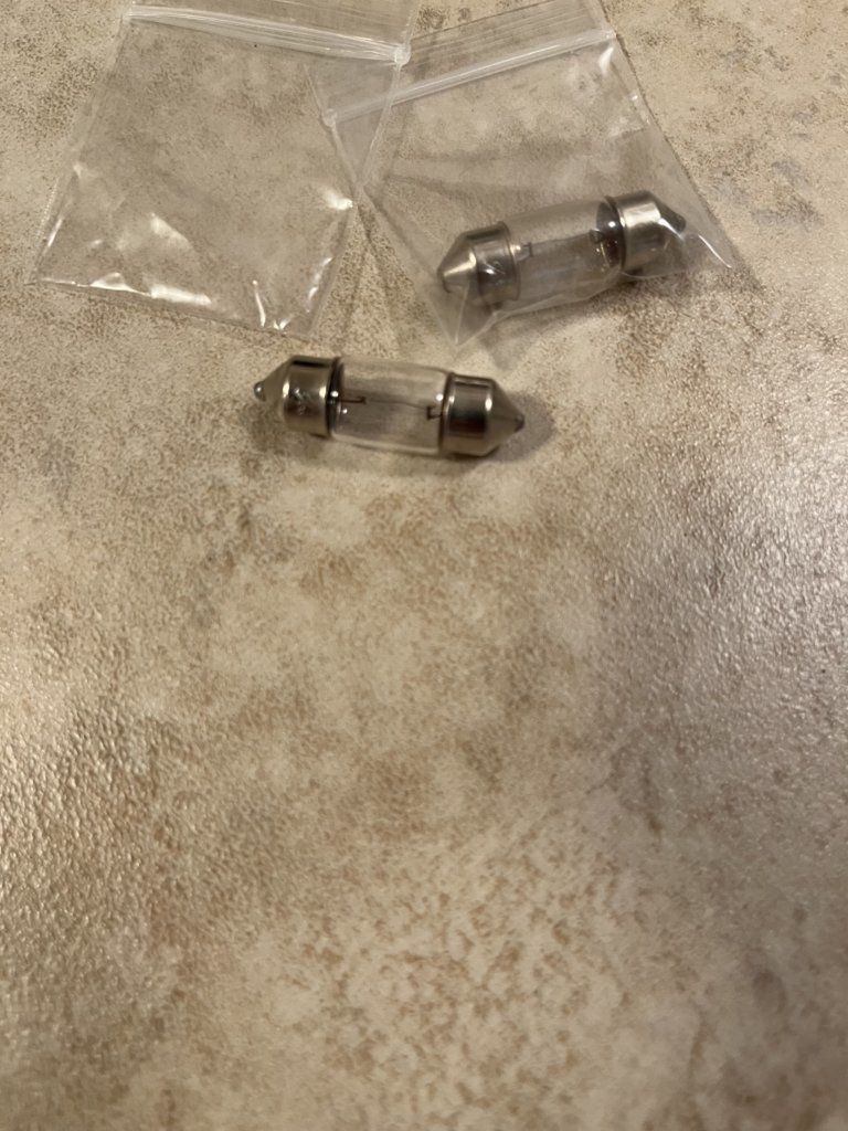

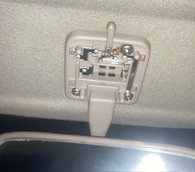

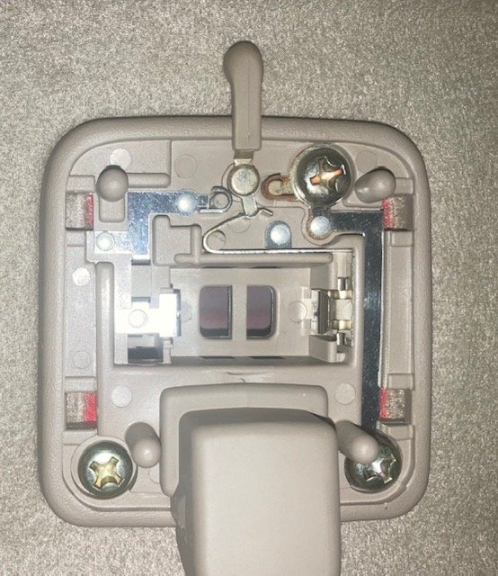

    I have just one light in the center above the rear view mirror.
    Bulbs will not fit into the socket. Not an LED like yours.

    Here are the ones that were in there previously.
    Couldn’t see a number on them

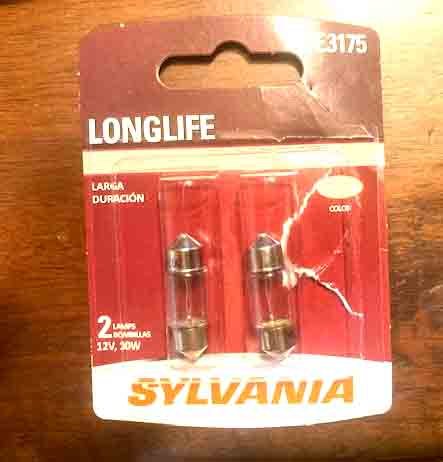

    Dealer did not have in stock. Told me to go to NAPA
    NAPA lamp number is (LMP) 13050N
    It is the right size, fits the socket, works.
    Still very difficult to place into socket!
