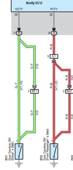

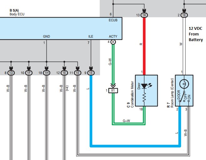

    Jimmyh
    Jimmyh Well-Known Member
    May 16, 2012
    #78991
    14,276
    SC
    2012 Prerunner SR5
    Well no, That doesn't compute as the door switch provides a ground for the dome light through the Body ECU. If the switch was shorted to ground or through the switch the light would stay on all the time.
    I do agree that it is most likely a problem with the door switch that is not closing when the door is open or it could be a loose wire or the switch itself is loose in its mounting only providing a loose connection to ground.
    See the pictures below:
    And
    10trdtaco[QUOTED] likes this.

    Jimmyh
    May 16, 2012
    #78991
    14,276
    SC
    2012 Prerunner SR5
    When the button is out the door is open and the switch provides a ground for the light and it come on.
    When the door is closed or the button is pressed in the ground is removed and the light goes off.
    ( Look at the circuit I posted above )
    Remove the rubber boot around the switch and unbolt it from the door opening, get a multimeter and check it for continuity.
