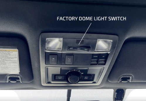

    Ever since a few days ago, my dome light wont turn on. I checked the fuse and its fine, I got a new bulb and it wont turn on so what else can it be? Yes I tried to tun it off and turn it back on too but nothing.

    Check the switch by the map lights. I’ve made this mistake too.

    Where is this switch? I'm sorry im new to this sort of things.

  5. Apr 5, 2023 at 8:20 AM

    You can also press each light individually for a total of three switches.

    512
    Two Trucks
  8. Apr 5, 2023 at 8:31 AM
