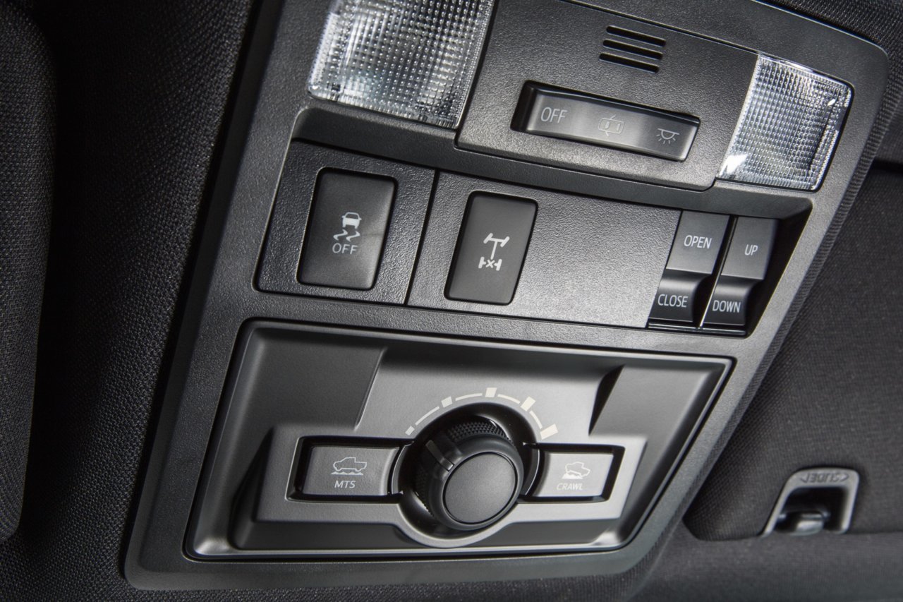

    Is the dome light switch on?

    ^ What he said. I've done this before and freaked myself out. Thought I blew something because I had just done an LED swap.
    Check your overhead console switch

    There are 2 ways to turn on dome lights:
    1. Check the buttons next to your crawl control - make sure it either a.) ON or b.) Door
    2. If #1 is A or B, dome lights should work (switch dome lights to ON)

    Just an FYI, all dome lights are controlled off the center overhead console. If that is bad or unplugged, no dome lights in the truck will work so I'm suspecting something is wrong with that switch or the console PCB circuit.
