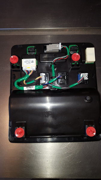

  5. Dec 6, 2015 at 10:17 PM
    #85
    splitbolt
    splitbolt Voodoo Witch Doctor
    Mar 7, 2010
    #32761
    7,858
    NW Arkansas
    2016 TRD OFFROAD DCSB MGM
    This help any?

  6. Dec 7, 2015 at 3:29 AM
    #86
    thepinktaco
    thepinktaco Well-Known Member
    Jul 4, 2013
    #107608
    691
    Cody
    Orange, MA
    95 SAS Tacoma, 99 4runner, 16 Tacoma.
    Roof console box has its own circuit board. Running short to ground through a circuit board isnt usually going to end well.
