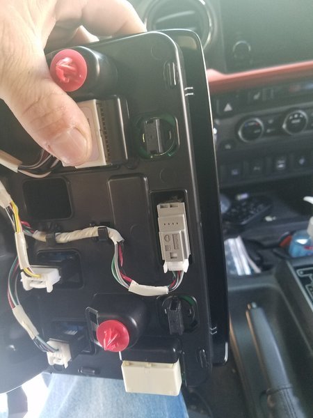

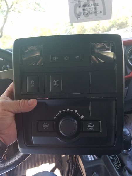

    Had same issue with mine. One led was blown. Fried the conection wire and in turn fused the center console overhead light switch. The switch is $193.00 through toyota for the 3 pos on-door-off switch. Does anyone know where else i can find this switch.
    This console is sealed from factory so any work on it can void warrantee. This is probably why the entire console is being replaced.

    This just happened to my 2018 and now that i have been reading i am guessing i will be in need of an entire new overhead unit. My fuse blew just like the original OP and now my light remains on even after the door is closed
