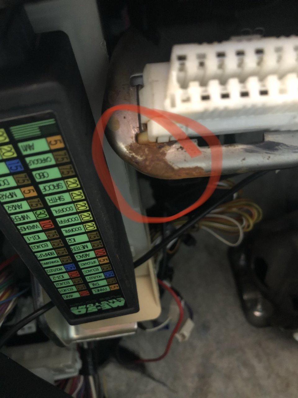

    Your dealership diagnosis may be correct however water infiltration into the cab is the more likely cause. Check the bare metal around the OBDII port for rust it’s a dead giveaway for water getting in the cab from above which is adjacent to the part you plan to replace see photo for clarity.

    **Update - just spoke to the dealer and they mistakenly shared the wrong part number with me. The affected part is the Body ECU. @Ronzio, The original cause was almost certainly poor LED's that was caused a voltage related component failure on the Body control board so, thankfully, no water intrusion to troubleshoot. The bad news is that a replacement unit is over $300 and I need to have the dealer do the install so they can program the part for my VIN (so anti-theft & audio works correctly). Sigh...steep price to pay for shiny LED's in the map lights. Needless to say, OEM bulbs are installed now & staying put.
