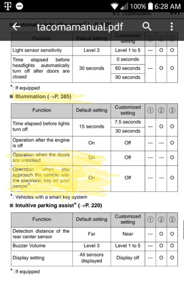

    How in the world do you turn on the dome lights when you unlock the doors to the vehicle.
    I am getting into a dark car at night. No lights on the door locks. No dome lights. Kinda a pain when I have someone waiting to get into the car and I cant see the door locks or anything around me. Im sure its in the radio functions but I could not find it. Maybe its in the on dash menu. Didnt look.. now that im typing this. Any help ...

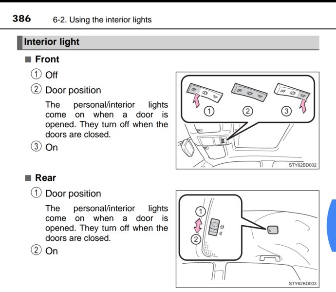

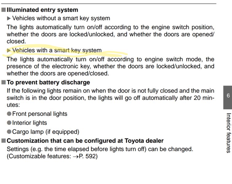

    Default settings are on. It should turn on when you approach the truck if you have smart key, which your profile says you have a Limited, so you have smart key.
    Capture+_2017-04-26-06-29-52.jpg Capture+_2017-04-26-06-33-56.jpg Capture+_2017-04-26-06-35-20.jpg
    Hope this helps.

    I didnt relize there was a switch for the back seat lights.
