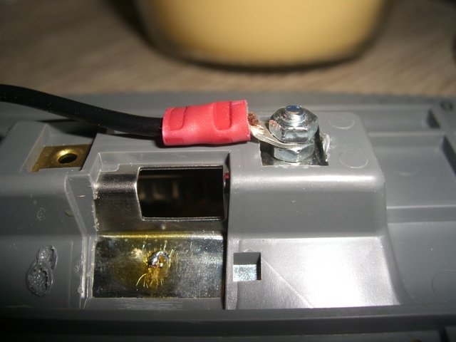

    I'm no mind reader, but I do guess the "advice" is from someone who has a bent headliner and also has something similar to this:
    Which would cause an always ON center lamp, draining the battery. But no, there should be no metal clips holding the lamp that mates to the roof metal requiring axle grease...:rofl::rofl::rofl::rofl:

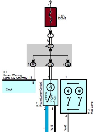

    Since the dome is a HOT fuse (always on).

    You can't, has to be locked by a mod. No reason to lock it and look ^^ he got you the wiring diagram to get you squared away :thumbsup:
