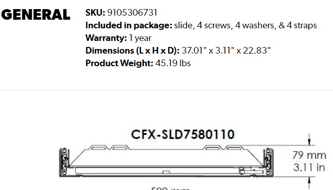

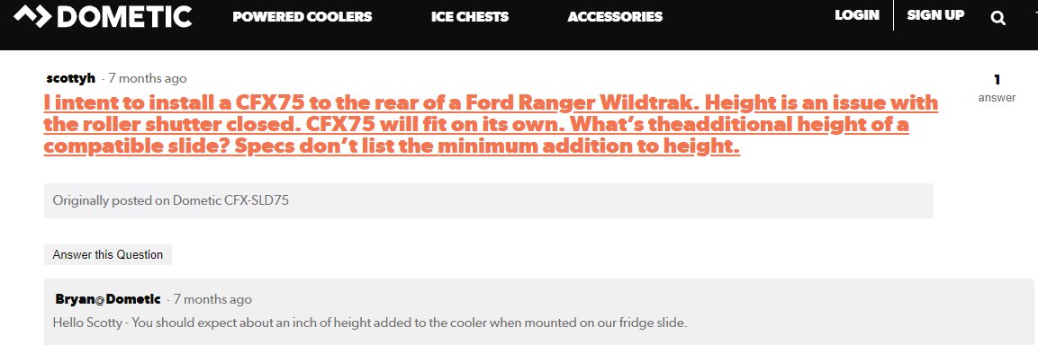

    So I am in the process of purchasing a Dometic 75 with the slide and I am wondering if anyone had this setup with there diamondback cover?
    wanting to make sure it all fits underneath and cover will close.
    I have done the measurements for the Dometic (18.58in) and clearance is there which is (19.10in) I just don’t know when adding the slide to the equation if I will run into an issue.
    not exactly positive how much added height the slide raises the fridge. Any in-site or photos would be great.
    Thanks.

    Based on the below, I'd bet it adds about 1 inch to the height. I'd be worried that it wouldn't fit.

    Yeah looking like it may be about .5 too y’all. That’s a bummer. Only other option would Possibly adding a thicker stiffer weather stripping to my diamondback which could help raise it a bit to provide the proper clearance.
