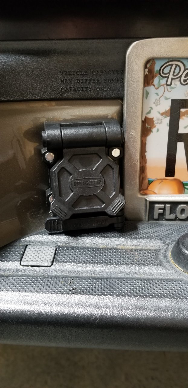

    Here's an example (not my truck) but should give you an idea.

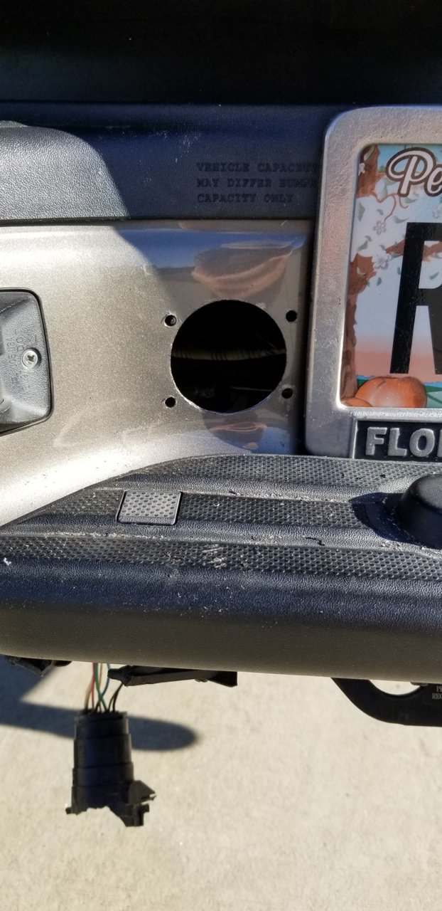

    That's definitely less exposed...just wanted to avoid drilling a hole in the bumper for now...We'll see how she goes.
    Are there any safety concerns I should be aware of running that 110? @bagleboy @6 gearT444E
    I'm assuming it's grounded through the outlet on the building where I plug in...

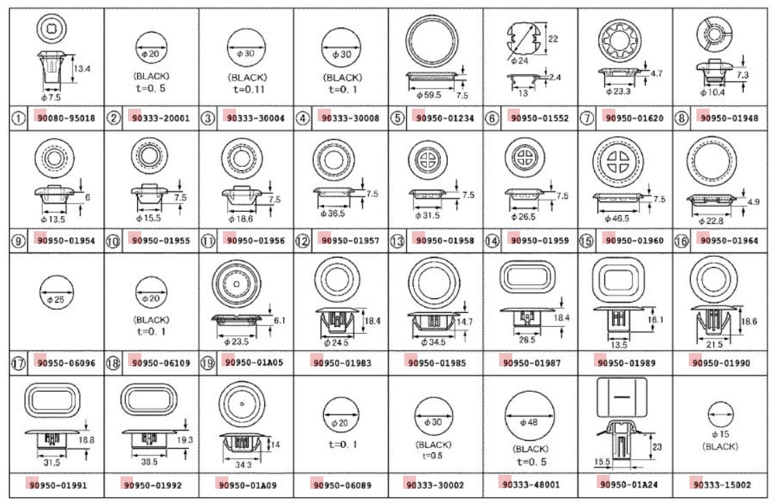

    @bagleboy I checked last night and it does look like there is a missing grommet...definitely carpet padding. Any idea how to get a replacement for that?

    Should be no concerns, yes the plug will be grounded through the outlet, do NOT tie the AC ground to the chassis. Ground fault protection will be through the extension cord and back through the breaker. I would recommend when using the 110V plug to use a GFCI protected power source.
    You'll have to measure the hole diameter, but here are the grommet and plug P/Ns

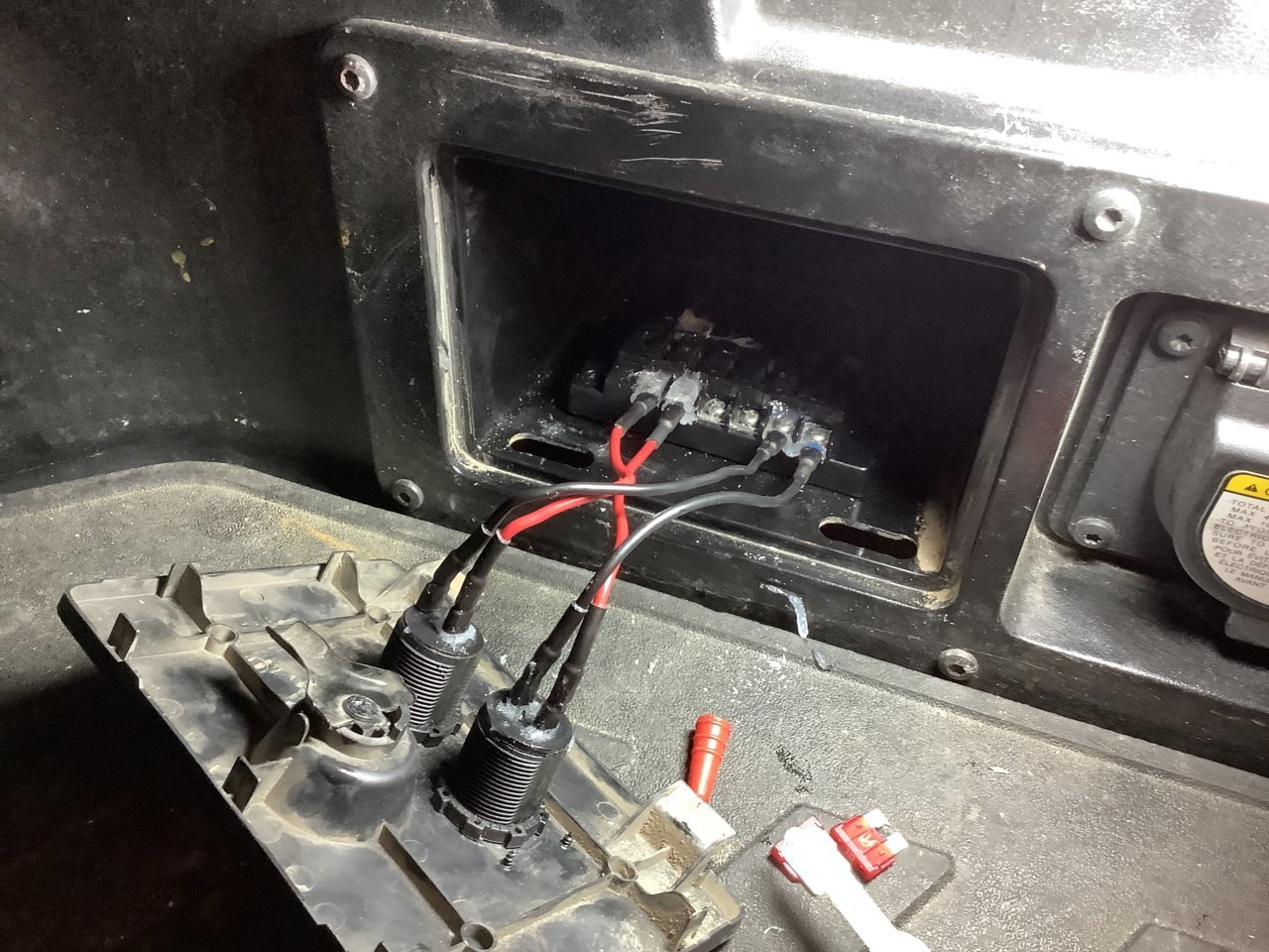

    I have a Dometic CFX-75 in the bed of my truck. I ran a 10ga wire from a X2 31M battery to the rear storage box on the passenger side. I hooked up a small Blue Sea fuse box and from that I did I power outlet and a couple of USB ports. I added a circuit breaker in line at the battery. For the power outlet I used an ARB outlet, because you can screw in the plug from the fridge. The Domestic fridge should have a low power Battery protection cutoff to save the battery, at least my does, low=11.4v/med=12.2v/high=12.6v.
    I know the battery protection works, as I am in the need of adding a second battery or solar to keep the fridge on.
