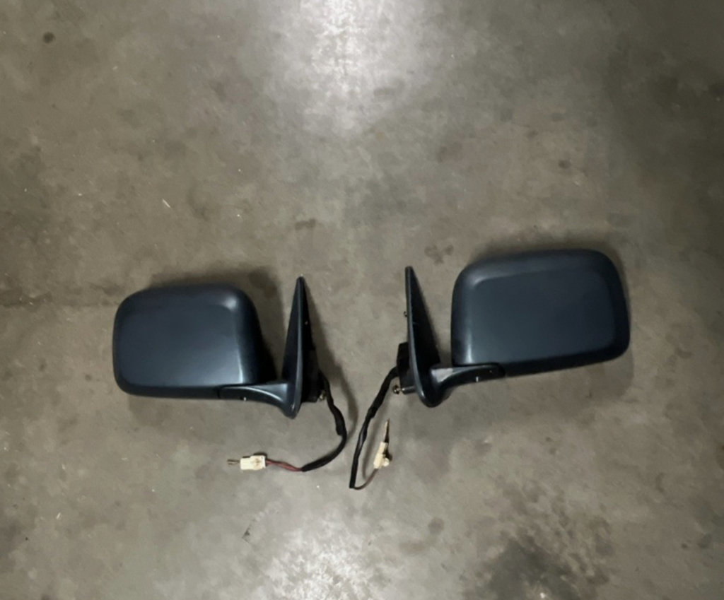

    New lower ball joints, upper ball joints, inner and outer tie rods good idea as many mentioned, and go with OEM for those, very important quality wise.
    Steering rack bushings if yours are worn, go with Total Chaos (first choice) or Energy Suspension, polyurethane superior to stock rubber.
    IMG_6046.jpg Mirrors from an 01-04 (94-02 4Runner work too) are a big step up over the 95.5-00 ones, much bigger viewing area (and power if you wanna do the work), plus hated adjusting them every time someone bumped them in the parking lot.
    Again, I’d go oem, aftermarket ones work okay but many shake and deteriorate faster
    I’d get a spare tire asap
