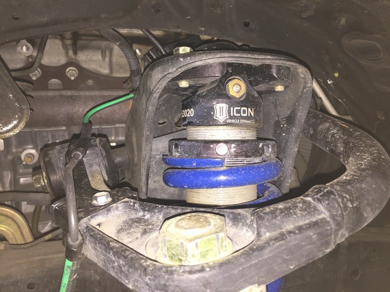

    That's a lot of pre load?

    It's well over the recommended amount of preload.
    Considering you're on stock control arms I'd say your lift(preload)is preventing your alignment from being what most consider to be acceptable.

    Well shoot,
    So I need to get different springs to achieve the same lift more comfortably (less preload) plus rebuild them, then it would be smart to get different UCA to get proper alignment?
    Then new leaf pack to level out the rear to acomadate for the added weight in the back?

    @Firebird
    Meant to tag you, posted some pics a little earlier from the front, thought I could get your 2 cents
    Firebird likes this.

    Hey dude, took a look and there's a few things I want to point out:
    -You have a lot of preload, you might be better off with a 14" coil instead of your current one. Make sure whatever coils you buy don't taper (oem does).
    -You're going to want to get an aftermarket UCA asap. It will fix your camber and caster. Also, if your coilovers are extended travel (no clue if they are or aren't) you're going to blow out that ball joint in no time if you're wheeling it. Go with a tubular UCA, find out if you have the extended travel coilovers and if you do go with a uniball instead of a ball joint. This is going to fix a lot for you.

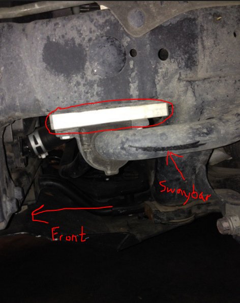

    -Check to make sure your swaybar has a relocation bracket like this:
    I also don't like your rear leafs. They might be fine, but I really think you'd do well to swap out to a whole new leaf pack. You're going to need to if you're looking to lift it a bit more anyway. Just don't forget extended brake lines and new (longer) U-bolts.
    If you fix the CV tear, get new coils, rebuild the fr & rr shocks, get a leaf pack, and grab UCAs you're going to have one hell of a ride!
